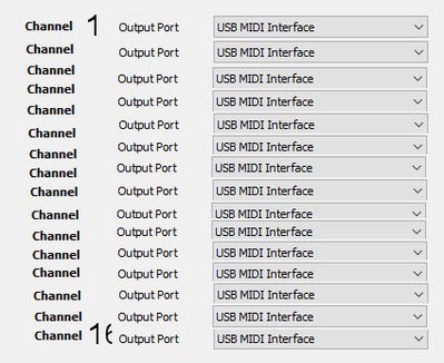

Reply 679 of 1702, by RetroGC
HI,
I would like to ask if could be possible to insert an upgrade to your software.
I'm writing this because I've bought a midi patch with 8 port, so now I can choose from 8 port where i want to output the midi file. What I would really like to do is to assign multiple output (one output for each channel so that i can have 16 different output (and i can decide if I want to use 2 channel try to use 2 synth simoultaunesly or even more). In this way I could be able to use several synth (without program each synth... btw some synth has not great feature to mute some channel).
As my english is not so great i tryed to make a design...
Thank you for your help.
Aldo
