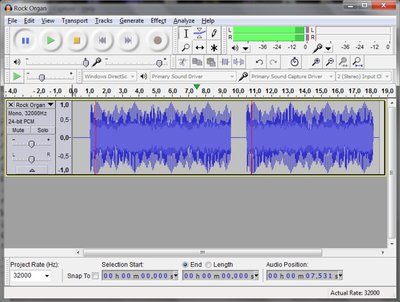

Reply 901 of 1746, by Falcosoft
Please be a little bit more specific. Instead of writing down what you did NOT do you could describe the exact steps you had done. And also some details about:
1. What software you used for recording?
2. What exactly you recorded from SC-VA itself?
3. How simple gain VST is a part of your process?
4. What sample rate and bit depth you recorded at?

1. For recording I used SCVA and Soundfont MidiPlayer.
2. I recorded instruments with stereo sounding. For this I maximally panned nesessary samples to receive source samples.
3. Simple Gain VST helps me make recording samples louder (Gained samples have little less noises than without gain).
4. 44100 Hz. My favorite. I checked 32000 and 48000. Both are awkward. First have squeak, second, in my opinion, is too soapy.
There's new recording. First sample used parametres:
SCVA Pan: L63
SCVA Level 127
SGVST Gain: 0 dB.
SGVST Balance: R10.
Second sample used parametres:
SCVA Pan: L63
SCVA Level 127
SGVST Gain: +12 dB.
SGVST Balance: R10.
https://drive.google.com/open?id=1--V5fjuxDa_ … 7Sn9uuD9x91nyNi

SCVA Pan: L63 SCVA Level 127 SGVST Gain: 0 dB. SGVST Balance: R10. Second sample used parametres: SCVA Pan: L63 SCVA Level 127 S […]
SCVA Pan: L63
SCVA Level 127
SGVST Gain: 0 dB.
SGVST Balance: R10.
SCVA Pan: L63
SCVA Level 127
SGVST Gain: +12 dB.
SGVST Balance: R10.
275.34 KiB
1715 views
You wrote that the 1st sample was recorded at 0 dB and the 2nd at +12 dB. Yet both samples in your recording have the same peak and seem to be normalized. Should not you upload the raw, not normalized samples instead?

OK, now I think I understand what your problem is. When you use simple gain VST it works with 32-bit floating point data since in VST world everything is floating point. But your recordings are all 16-bit integer ones. So they have smaller dynamic range and when you normalize them or add 12 dB gain in Audacity you also raise the noise since the original dynamic range has already lost at the 32-bit float -> 16-bit integer conversion made by Midi Player. Somehow I believed that you always use 32-bit floating point data at recording since your first images showed 32-bit floating point samples in Audacity. So you should check the the '32 bit float' checkbox at the right hand side of Midi Player's file select dialog after you press the recording button. This way audacity will have the same headroom with your 32-bit floating point recordings than simple gain VST has with the real-time 32-bit floating point data.

Please read again. I have just tried and in case of 32-bit floating point recordings I get the exact same noise level If I record with Simple Gain Vst +12dB option or with 0 dB option and amplify +12 dB in Audacity afterwards.

I understood. But the problem is in gain: less gain - more noise. More gain - less noise. This is why Simple Gain VST requires 24 dB as gain range max value.
NO, you do not understand. The problem is you used 16-bit recordings, thus decreasing the dynamic range and then you tried manipulating the already 16-bit integer data. While you stay in 32-bit floating point domain (also in your recordings) the equation is: less gain - SAME noise. More gain - SAME noise (proportionally)
That's why there is absolutely nothing requires more Gain, even +12 dB is absolutely unnecessary at real-time.
You can do the same at post processing in your wave editor.
