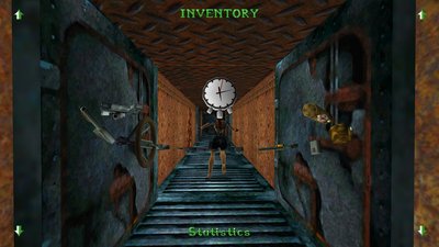

I found funny bug - in Wreck of the Maria Doria level inventory and menus models are upside down 😵 Also checked in plain Steam version without your patch - all is fine.

It is not a bug. It is a feature

Ha, maybe!

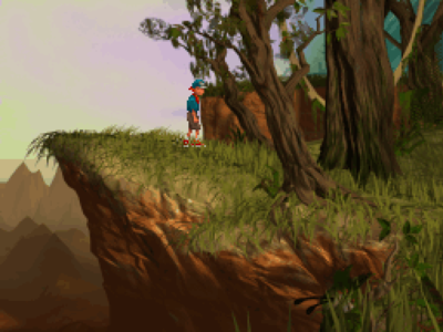

Heart Of Darkness is using two upscalings at the same time resulting in some lines being way thicker than others.
Pardon me, but i don't get what you're saying
My patch uses two "upscalings" at the same time ? No it doesn't
Heart Of Darkness does it ?
you see some lines thicker than others only when you use my patch ?
Where does it happens ?

Reply 294 of 892, by robertmo
You provide two options for the game:
[v] Enable upscaling
[v] Remove black frame
both resulting in it's own independent upscaling.
Upscaling the upscaling doesn't look good 😉

Nope. The emulated front buffer is always only upscaled once. The effect you describe must be due to another thing.
Where does it happens?

Notice the last two vertical lines
file.php?mode=view&id=47402
Zooming in on your image, i could really see that some lines would repeat 3 times and others 4 times, that is not what one would expected when upscaling from 384 to 576, but then running the game "vanilla", i can see that every vertical line already repeats 2 times: the game's vertical resolution is actually 192 upscaled to 384. Here are the two scalings you refer to. Anyway, I'll see what happens if i downscale the game 1st before upscaling it, but i doubt there will be any visible difference
On a second thought: 576/192 = 3.0, so yes, downscaling 1st will improve quality (if you have a 720p monitor)
