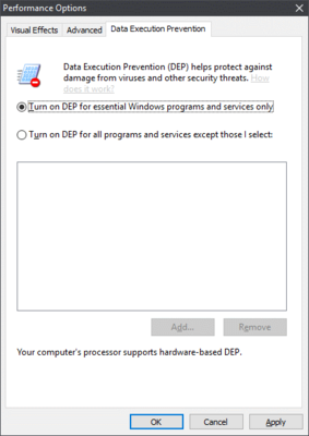

Reply 622 of 892, by cloudhaacker
Guizin239, not saying this is the problem, but I had issues with my Final Fantasy games a few months ago and the culprit was Windows Data Execution Prevention. Try either adding an exception to it for Help.exe or try disabling DEP and see if that helps.
Reply 623 of 892, by ZellSF
Don't tell people to add exceptions to DEP. Because of confusing wording, people tend to actually enable it to add an exception (which is of course, pointless, but people aren't that good with logic and reading). The DEP settings should look like this, which they do by default.
12.22 KiB
3105 views
Also don't tell people to disable DEP because then they might figure out how to disable it entirely. Just tell people to set DEP settings to the default and make it very clear what those defaults are (pictured above).
