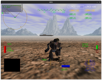

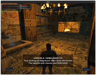

It's a dream come true 😁 !
With the Glide 2.1.1 wrapper, I have finally able to play Mechwarrior 2 31st 3Dfx on Linux laptop on QEMU KVM with Zeckensack's Glide Wrapper at 1280x960 using the wrapper high-res option to double the resolution. It plays smoothly hovering between 20-30fps, which is perfectly fine and does not hit the jumpjet slow recharge issue if it approaches 60fps. The mesa dessert map of Trial of Grievance is a huge map and it is typically slower than typical missions.
Thanks to Linux KVM, it does not even require bulky desktop with powerful CPU and hot-air blower GPU. The game plays perfectly fine on Core i3-4010U and Core m3-6Y30 with their respective Intel Graphics.

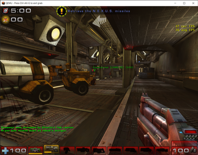

Anyway, I am thrilled with the improved performance, Unreal Tournament 2003 is now playable through OpenGL on QEMU 😀, all from a petty fanless, 8W TDP Core m3-6Y30 Skylake-GT2, Windows 10 and Linux, even on battery (but it will drain fast 😜)
UT2003 demo benchmark wrote:
Flyby 148.59FPS
Botmatch 73.79FPS
Resolution 1024x768
And, MESAGL pass-through seems to be able to achieve 90% of native performance in QEMU for advanced OpenGL techniques leveraging VBOs that minimize per-frame drawing calls instead of client-side vertex arrays. DOOM3 (2004) is still not playable but it runs better without crash by exposing the VBO extension.

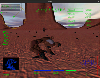

Mechwarrior2 Mercenaries from Titanium series. QEMU KVM MESAGL pass-through with Zeckensack's Glide wrapper, up scaled to 1280x960.
The frame rate was simply phenomenal 😳 regardless of how intense the actions going on, it simply locked at 60FPS. I remember I was not able to get this kind of performance running the game on Windows XP with compatibility mode on a Core 2 Duo E8400 and Geforce 9400 regardless of Glide or Direct3D. The frame rate would drop below 15FPS during missle firing and explosions and the stutter was obvious when such happened. I was very disappointed back then because the new system no longer support Win98. Now, worry no more 😁, and it plays well even on petty, power efficient laptops.

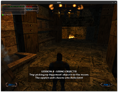

😁 Anyone remember this game? One of the tough games released in 2001 that required high system specs of the time to play. It wasn't very optimized, but luckily it supports 3Dfx Glide.
It is now playable on Linux KVM, on 8W TDP fan-less Intel laptop. Up scaled to 1280x960. The OpenGL renderer was unfortunately extremely un-optimized and was unable to attain playable frame rate. The same shot position with dynamic lights and shadows on OpenGL renderer only achieved 13~15FPS.
1.57 MiB
2581 views
Severance Glide
More on Severance...
1.84 MiB
2531 views
Severance OpenGL
Severance OpenGL rendered at native 1024x768. It won't get more FPS by reducing resolution or less FPS by increasing resolution. So basically this game trying to achieve the level of details with just OpenGL 1.1 level APIs, not very efficient in VM context of passing through GL calls, but the textures, lights and shadows are different from Glide rendering. Nothing good or bad anyway, Glide still looks OK even though the wrapper had upscaled from 640x480., though that is a personal taste. OpenGL render plugin is beta and unsupported, so that's about it.
Update: Look like I was wrong. I forgot to make EXT_fog_coord GL calls into FIFO hence causing frequent VMEXIT when the GL calls were used in the games. After fixing this, Severance OpenGL is fully playable and perhaps on occasion vsync should be enabled to prevent from drastic FPS fluctuation at 1280x960 native rendering resolution.

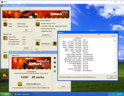

I was able to get a WineD3D working over QEMU MESA GL for accelerated Direct3D games on Window XP guest. This was from a past version of Wine-staging 1.8.6. Long story short, the entire Wine development is Linux focus and re-purposing any of its components for Windows VMs is challenging. So I tried out several versions and 1.8.6 was so far doing great at least for some games that I was interested. The compatibility was either hit or miss, and due to Windows XP aging MSVCRT more recent versions of WineD3D would not work. Win98/ME does not work yet, although I would love to be able to get it working there for better legacy games compatibility for DirectX5~7.
This is essentially running a Direct3D guest wrapper on top of OpenGL guest wrapper in emulated guest environment, the overhead is high. It is still very much WIP to identify any opportunity for optimization to speed things up and make more efficient use of FIFO to bulk up the payload. Since this was an old version of Wine, not everything would work. Any Direct3D apps/games that require windowed mode (for setup, cut-scenes etc) or mix GDI32/DirectDraw 2D calls with Direct3D are likely to be in troubles due to the way MESA GL pass-through was implemented.
Here's some of the games/demos I tried:
  • PCPlayer Direct3D benchmark (DirectX5). Run 1024x768x32bpp at near 60FPS but app fault 0xC0000005 on exiting demo.
  • Tomb Raider II (DirectX 5) good.
  • Shogo MAD (DirectX 6.1) good.
  • Blood Rayne 1 (DirectX8.1) run very slow <5FPS. The same scene with OpenGL rendered at ~35FPS.
  • 3DMark2001SE (DirectX8.1) OK.
  • 3DMark2000 (DirectX7) crashed OK - Fixed.
  • MotoRacer 1 (DirectX3) game crashed, 😁 yeah it worked by setting desktop color to 16-bit instead of 32-bit
WineD3D over QEMU MESA GL
    603.16 KiB
    2387 views
    WineD3D QEMU

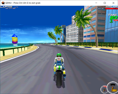

Yeah, WineD3D works on Win98/ME!!😁 Some old Direct3D games (pre-DirectX5) may require setting desktop to 16-bit color as they can't handle surface descriptor from WineD3D for 32-bit color. Moto Racer 1 which is actually DirectX3 seemed to be one of those. With Win98/ME on QEMU, it is now very easy to get Moto Racer 1 working simply by installing from CD and applying the final official MR3.22 patch for full Direct3D version.
Unfortunately, the game resolution is limited at 640x480, which is kinda lame for today's standard and WineD3D does not have scaling option (correct me if I was wrong). Otherwise, it will be still fun and thrilling to play it on modern systems. Other Direct3D games such as Tomb Raider II, Fighting Forces and Rage Incoming support all the resolutions reported by Direct3D which makes them still play great on modern systems. Moto Racer probably made a short-sighted decision back then that no Direct3D hardware was capable of rendering higher than 640x480 at acceptable frame rate for such a fast paced game.
Anyway, 640x480 would still be OK on 1366x768 HD panel on most 11.6" valued laptops.
Moto Racer 1 full D3D on QEMU
396.23 KiB
2359 views
Moto Racer 1

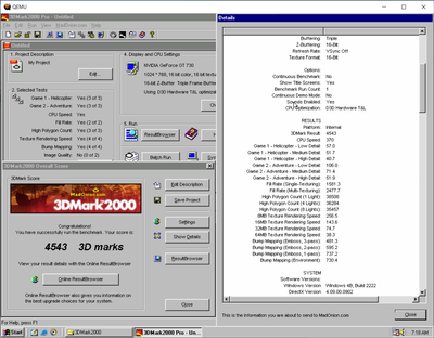

Reply 17 of 52, by kjliew
3DMark2000 now works on Win98 VM from QEMU with WineD3D.
WineD3D on Win98SE guest
234.01 KiB
1291 views
3dmark2000
Update: Reload 3DMark2000 for more realistic scores. Previous scores was inflated due to erroneous implementation of some GL drawing calls, making Game 2 run at higher FPS with incorrect rendering.

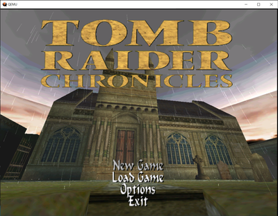

Tomb Raider Last Revelation & Chronicles now work. They seem to use the same engine based on DirectX 6.1 & 7.0. The engine triggers the WineD3D code path that uses multi-level OpenGL context. I had never thought of multiple OpenGL context since full-screen OpenGL games typically only need a single rendering context, so it took me some time to rethink on OpenGL context handling and make it work for WineD3D use cases.
WineD3D renders the Last Revelation in full brightness which is a known, documented issue in Wine's AppDB, but the Chronicles is fine. If one ever complained about the Last Revelation being too dark, then perhaps this way of playing the game with WineD3D would be nice. Anyway, if anyone happens to know the fix for full brightness for Wine, please share it I could take a look and backport the changes.
Update: D3D7 lighting issues fixed in Wine 4.12. Details in bug 31260.
So all Tomb Raider series (I, II, III, IV & V) all run perfectly on QEMU. Except the first being DOS glide game, all the rest support higher than 1024x768 native resolution and 32bpp color. That make them superb for QEMU and better than any Voodoo/Voodoo2 SLI on retro PCs. 😁 Morever, as long as QEMU lives, the games run on any future PCs across Windows and Linux.
Tomb Raider IV on QEMU with WineD3D
1005.82 KiB
1816 views
TR4
Tomb Raider V on QEMU with WineD3D
[attachment=-1]TR5.png[/attachment]
    1.09 MiB
    2185 views
    TR5
