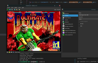

Something i've been working on, Sigma Designs Color 400 support. 320x200 and 16 colors. It's possible to use 640x200 or 640x400 and 16 colors, but the card is already too slow, so no point on adding support for those. The VRAM layout is very similar to the Plantronics ColorPlus, but uses different planes for red/green and blue/intensity combination (which makes it slower as a OUT instruction is required to change between planes).
184.15 KiB
940 views
FastDoom on Sigma Designs Color 400
One thing I've discovered is that this card is really picky, it doesn't work on fast cpu's (at least on 86Box). I've been able to make it work on a simulated 386SX. I did also buy one card but it didn't work on my 386DX nor my 486 (now I have to try on something slower).

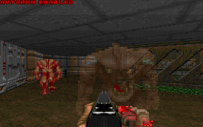

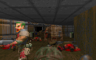

New feature that will come to FastDoom 0.9.5, translucent invisible objects rendering (like Heretic and Hexen do)
42.99 KiB
690 views
FastDoom 0.9.5 Translucent rendering 1
39.71 KiB
690 views
FastDoom 0.9.5 Translucent rendering 2

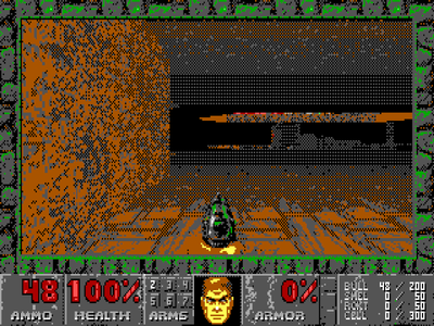

Here's a simplified manual mock-up of what I was thinking about. It's identical to the current EGA rendering, except for the areas that are currently mapped to black - which are replaced with dither patterns (black alternating with some other color, or even with more than one).
148.26 KiB
565 views
In other words, that could work if the colormap was able to dither *only* the darker colors. It's still brighter than the VGA palette overall, but not as bright as 0.9.3 EGA. The dithered areas lose some detail, but this only happens where you'd otherwise get black anyway - so it may be a good compromise between the current rendering and the original intent.
Just an idea; don't know how feasible it is, and it may simply turn out ugly. (Although if it was possible to implement using the colormap, I'm sure it would look better than my manually-doctored screenshot.)
