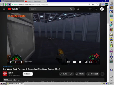

ZellSF wrote on 2022-12-27, 18:48:
I don't know what you're seeing that you're not liking
this what i see
110.79 KiB
1465 views

leileilol wrote on 2022-12-28, 00:27:
theelf wrote on 2022-12-27, 19:12:
this what i see
you are seeing encoding.
My GPU have very limited or not at all acceleration in web browser, then all youtube videos looks sharp, but this one is like my screenshot, then i assume the game have filtering

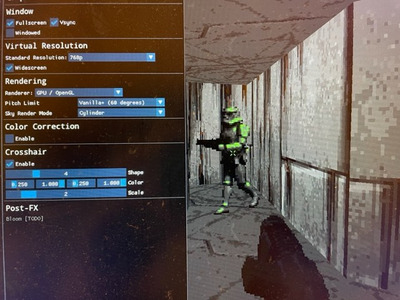

Reply 25 of 43, by Bondi
I get this kind of color glitches if I select hardware rendering. Green instead of white on the trooper, and also some other colors on the walls and the sky. Is there a fix for that? Still prefer it as there is perspecive correction in this mode. I play on a laptop with Iintel HD Graphics 4000.

Reply 28 of 43, by Bondi
gerwin wrote on 2022-12-29, 16:40:
Coincidentally I just read a similar thing here. It is so similar, maybe it is you?: https://github.com/luciusDXL/TheForceEngine […]
Bondi wrote on 2022-12-29, 16:26:
https://github.com/luciusDXL/TheForceEngine/pull/161
"I had no problem compiling it and music also plays with the software synthesizer. I didn't notice any issues so far, with exception of green colors caused by my Intel HD4000 I guess, even with the latest mesa driver, which can however be fixed with changing the values in fraq shaders files."
So, yeah, how do I change "the values in fraq shaders files"?

Reply 29 of 43, by gerwin
Bondi wrote on 2022-12-30, 11:41:
This post details things, though it does not read like a fix, more like a workaround:
https://the-force-engine.freeforums.net/threa … der-green-color

Reply 30 of 43, by Bondi
gerwin wrote on 2022-12-30, 14:44:
This post details things, though it does not read like a fix, more like a workaround: https://the-force-engine.freeforums.net/th […]
PS. I updated my 32-bit XPmod port yesterday. Now managed to make it build and run with fewer changes. Now to hope and wait, for a legacy-friendly renderer to be added, by someone more knowledgeable then me...
Thanks for the link! Changing the values to 256 seems to have solved the geen dots. I had to change also the gpu_render_quad to make the weapons look right.
