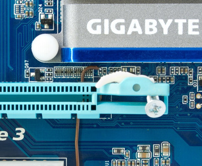

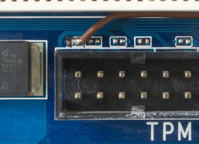

BTW I was able to milling off the copper trace jumper on my TPM pin 20 and then hooked a wire to LDRQ1# from PCH, so my MB Gigabyte GA-P67A-D3-B3 is ready for testing. I plan to send some batch to JLC...
