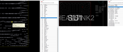

Reply 156 of 204, by myne
I might just add another note. Out of curiosity I compared a B365 board and a Z370.
The 1/2/300 series aren't meant to have LDRQ.
But... maybe the humans at Intel are human, and don't so much delete features as... stop documenting/supporting them.
And maybe board designers are lazy, and don't update their pin definitions when the basic chipset design is more or less an iterative evolution of the same thing rather than a revolutionary design.
So, this is the B365 and Z370 chipset with the Superio nets.
IF the above assumptions about human laziness are correct, then LDRQ#0 may still exist on both of those chipsets as GPP_A7 and logically, the same chipset straps documented in the 9 series chipset could enable it. In the 9 series chipset LDRQ#1 is configurable as GPIO instead. It might be possible that LDRQ#0 is missing but LDRQ#1 still works, and could be configured instead. Would that work?
Does this mean anything to anyone?
Bus Master Device Mapping and START Fields
Bus Masters must have a unique START field. In the case of the PCH that supports two LPC bus masters, it drives 0010 for the START field for grants to Bus Master 0 (requested using LDRQ0#) and 0011 for grants to Bus Master 1 (requested using LDRQ1#.). Thus, no registers are needed to configure the START fields for a particular bus master.
https://www.intel.com.au/content/dam/www/publ … h-datasheet.pdf
    331.07 KiB
    686 views
Reply 157 of 204, by rasteri
myne wrote on 2023-04-26, 10:46:
It's possible I suppose. I think it's unlikely though so I'm not gonna spend the time trying it 😀 If you have a 100 series motherboard then by all means give it a go.
Does this mean anything to anyone? […]
Bus mastering isn't terribly useful for what we need to do, typically it was just used for stuff like hard drive controllers
