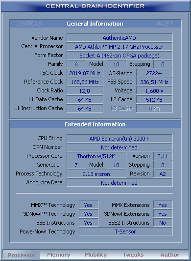

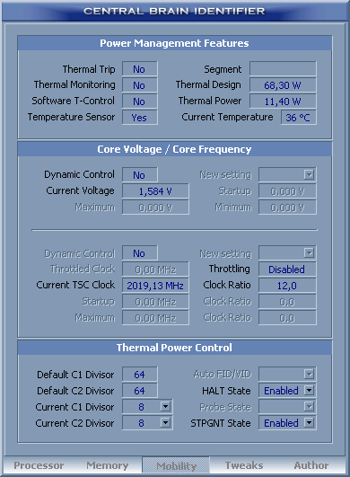

The AMD Sempron 3000+ CPU has the same Barton core as the AMD Athlon XP's, it could also have been called 'Athlon XP 2700+'. So it is just a marketing thing. The Sempron does have a slighlty lower voltage: 1.60V instead of the usual 1.65V. I don't know why the C.B.id screenshot says thorton core?. A must: Enable HALT state and STPGNT state (in your BIOS, or with 'Central Brain identifier' or with 'Cool-on'), it will decrease your Athlon's heat output dramatically, without any drawbacks. Most people advise to go for unlocked Athlons or rather Athlons XP-M(obile), yet the actual advantages over this Sempron are not that big.

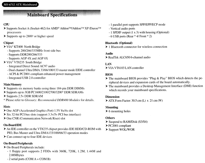

The MSI 6712 mainboard: AGP-8X + 6 PCI slots. No ISA slots. Look at Prophase_j's KT133 system if you want an ISA slot. The KT400 chipset works well with 333MHz memory speed. It was also expected to support 400 MHz net memory speed, but I read it did not work well. 400MHz kinda worked on the later KT600 (I have one of these too) but it is not that interesting. The MSI 6712 is one of the last mainboards to support DDMA/NMI for legacy sound in dos. The mainboard has solid support for S3 'Suspend To Ram' standby state which is a great feature.

    Central Brain identifier tab 2

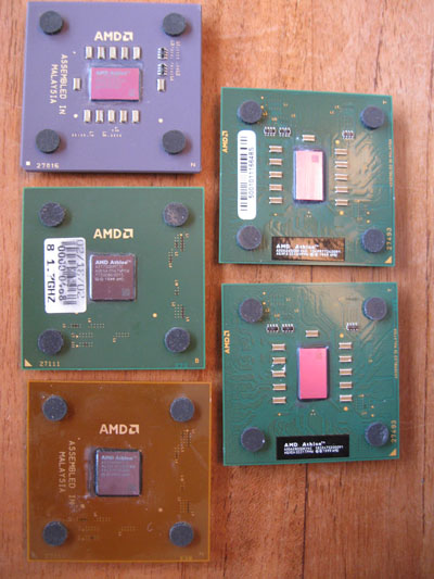

    69.06 KiB
    7985 views
    some AMD Athlon CPU's ranging 1100MHz to 2133MHz, the ones on the right are Barton core.
    77.74 KiB
    7985 views
    Mainboard Specs

@swaaye
Concerning the errors in the CPU identification: Maybe in the past I did the 'wire-trick' on the AMD CPU to see if I could unlock something, and left it like that.
