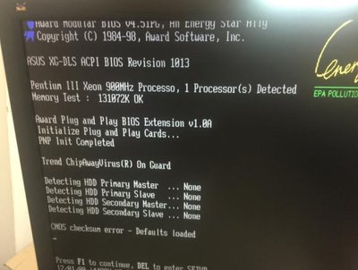

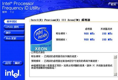

Reply 107 of 110, by Ponjiayulady

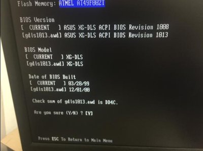

P3 Xeon 900Mhz (2.8v only) working on XG-DLS v1.03 is for sure,but you should update bios to newest 1013
like this
24.64 KiB
988 views
boot up successfully

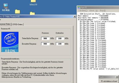

32.12 KiB
988 views
genuine 900Mhz spec

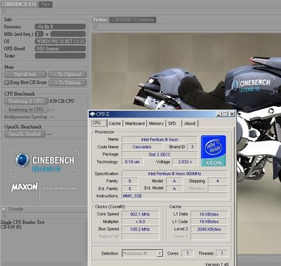

50.27 KiB
988 views
operation without any problem

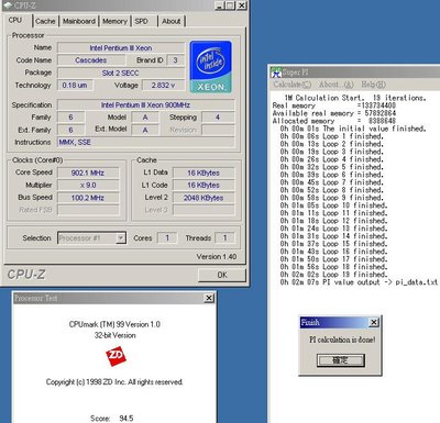

89.43 KiB
988 views
83.45 KiB
988 views

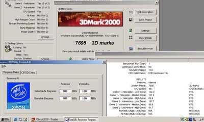

Reply 108 of 110, by Ponjiayulady
Unlike most P3 Xeon motherboard using integrated graphics
ASUS XG-DLS has one AGP slot,so P3 Xeon can work with AGP 2x or 4x VGA card
It's also suitable for CAD or gaming ,that is what most P3 Xeon systems can't do
72.41 KiB
980 views
90.71 KiB
980 views
