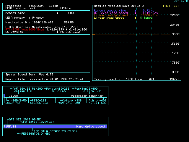

Motherboard: QDI U386WB
Chipset: UMC 481 and 482F
Cache: 128k 10ns
Memory: 4MB
CPU: AM386DX-40
FPU: No
Oscillator: Eclipse 100MHz
System is not stable.

Reply 108 of 325, by kixs
Are there any 486SX benchmarked with Speedsys? I'm wondering about the CPU/FPU issue that you can see when testing the 386 with a fpu and the score dramatically drops. I only have 486DX variants.
Reply 109 of 325, by Anonymous Coward
Carlostex, can you please run the test again with himem.sys disabled so you can do the memory test?
I recently bought a 100MHz oscillator as well. I am going to attempt 50MHz on my OPTi 495SX system. This chipset was used in 486 boards, so perhaps it will be able to handle the speed a little better.

Reply 114 of 325, by carlostex
Sorry i'm living in England and all my stuff is locked and stored at my folks place in Portugal. I'll be there early November but i'll hardly have any time to test this. I have a Turbo XT computer to build.

Reply 117 of 325, by carlostex
I don't think i have any motherboard that allows that. I think the cache is the main problem as the system was quite stable if i turned the cache off. Performance of the system at 50MHz without cache was about of a 386DX-33.
Reply 118 of 325, by Anonymous Coward
I am not sure if it's a problem with the cache chips themselves. With enough waitstates it should be perfectly stable. I set my wait states all to the maximum which should have done the trick. However, the system was still not really stable. I think it's either a cache controller, chipset or motherboard design issue. Remember even many 486 motherboards can't run 50MHz properly.
