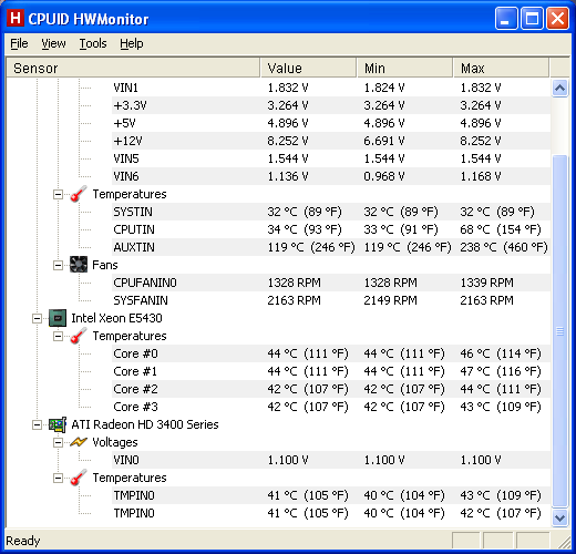

Reply 9 of 36, by mockingbird
Zenn wrote:
Funny, Wolfdale/Yorkfield was supposed to run pretty cool. My E5430 runs a bit too cool in fact, due to a faulty temp sensor that reads slightly below ambient (around 28-30 deg C) when idle. I've undervolted mine to 0.9750V but even before that, I don't remember such high temps at idle. That said, I'm using a Antec 620 CLC on my chip.
Is your 5430 C0 or E0? That could have something to do with it.
What are your individual core temps?
19.67 KiB
2457 views
I'm tempted to try undervolting. I've got to put up with the vdroop on this board though. My MB sensor was haywire when I first powered the thing, reporting 30-40C over the real temperature. It seems to have settle down now.

ZENN, is your undervolted E5430 Prime95 stable on all four cores? I'm using the stock copper-core Intel cooler off my Pentium D 925. It definitely runs a lot cooler than the Pentium D.

Reply 17 of 36, by Zenn
It's an E0. But uhh I usually use Core Temp instead of HWMonitor. You can see they give conflicting temps. How I arrived at Core Temp's values was that from what I've read online, the E54xx TJMax is 85°C. So I used an offset of 15°C since the program's default is 100°C. FWIW I downloaded AIDA64 and it agrees with Core Temp. So... majority wins? 😉 Anyway my board is a Gigabyte EP45-UD3.
file.php?mode=view&id=16303&sid=f11faa795b55502da6c5ad8cf3e2e5b7
111.22 KiB
No downloads
It's 2hrs Prime95 small fft stable. I know some people run longer but this is enough for me to test stability.
