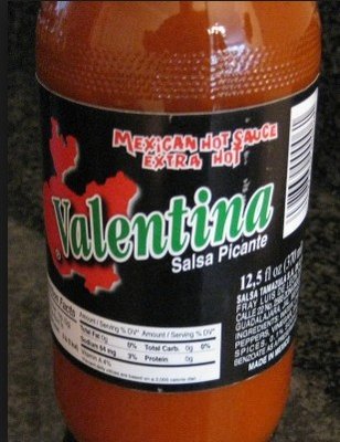

Reply 3 of 26, by PCBONEZ
bristlehog wrote:
What can I do to handle the rust?
If there is pitting (and it looks like there is) the only truly effective ways are sand-blasting or by using chemicals.
I will assume you don't have a blast cabinet out back....
Problem is I dunno what is available to you over there in the way of chemicals.
Ospho is probably the best. It's been around since the 40's and it's original use was for boats. (Marine applications.)
http://www.ospho.com/
It is acid so you need to take common sense precautions but as formulated it's not a super strong acid like battery acid.
Then there are various more consumer oriented rust converters that are usually available at automotive supplies.
--- Rust converters work by further oxidizing the red oxide into black oxide. You want to remove any loose flaky stuff before you use it but not the red fixed rust.
--- Black oxide rust does not progress like red oxide. It forms a layer that oxygen can't get through.
--- Painting is optional after rust converters. Not needed but it does look a lot better.
And if you like messy and want to go redneck any Tabasco Sauce knock-off that you can get in bulk cheap should work.
This actually works very well due to the hot sauce's acid content. Not sure if it helps but I prefer the hottest hot sauce I can get cheaply for this.
I've used the stuff in the pic below with great success. It comes in big bottles and is fairly cheap. Dunno if it's available outside the US and Mexico though.
For this you will need one of those wire brushes that look like tooth brushes to work it around while you soak it.
Put it on thick and work it around now and then with the brush. An hour or two of soaking with intermittent scrubbing should do. (For steel.)
Once you've got all the rust off hose it off (or give it a shower) and then immediately douse it with 91% isopropyl to dry up any residual water.
Then, for this one, you will need to paint it if it's steel.
This is actually an old Navy trick to clean the blue-ish/green-ish crud off of copper and brass pipes but it works well on steel too, just takes longer.

Reply 6 of 26, by bristlehog
We have McIlhenny Tabasco sauce here, yet I will keep the sauce for my cooking exercises. I'll get myself some rust dissolver in an automotive shop.

Reply 7 of 26, by PCBONEZ
saturn wrote:
Wouldn't vinegar work better?
Vinegar is not thick enough to stay put.
If you wanted to acquire enough to submerge the case in vinegar it might work okay.
