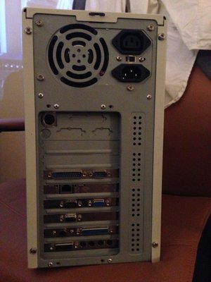

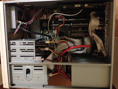

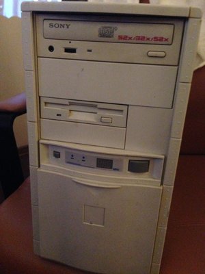

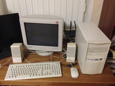

So, this is the machine I picked out as a starting point:
1.35 MiB
1953 views
Fun fact: I bought this from an actual (ex?) FSB officer family. I didn't know until I came to their block and realised I can't get through security without company, which is unusual for a Russian residential area, to say the least. For those who don't know, FSB is Russian intelligence, kind of like CIA. When I got to their apartment, my host acknowledged the whole FSB thing, and there were a lot of FSB memorabilia (banners, medals, etc) lying around 😀
Looks like this was a Formoza build — that was an OEM popular in 90s Russia. I did not get a horizontal desktop case, but this case also has value for me — it's exactly the same no-name case I had as a child in a Pentium II machine. So, yeah, that was right in the feels, folks.

Next came the 80 gigs HDD issue. My LuckyStar motherboard does have an 120GB support patch, but looks like it's for another revision. Anyways, I couldn't apply it. So I decided that I want another motherboard.

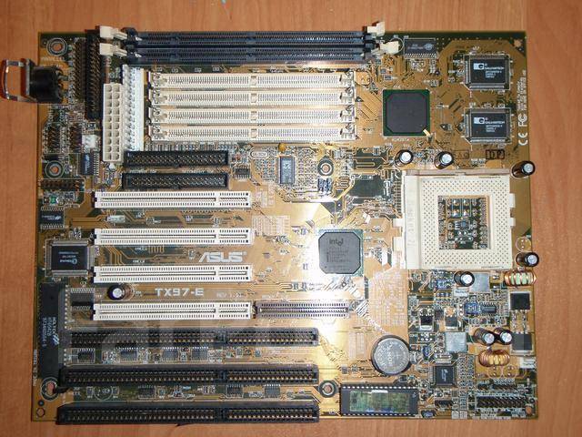

Asus motherboard
I always had Asus motherboards, and so my first pick was an Asus TX97-E. I bought it for 2,5 bucks with a Pentium 120 megahertz CPU and some SIMMs.
1302105752438_bulletin
With it came my first experience with motherboard jumpers. If someone wants a facepalm moment, you can read it here. Long story short, looks like I fried my Pentium MMX, though I'm still not sure what exactly I did wrong.
The next revelation was that Asus motherboard did not use common PS/2 and USB explansion cards. It needed a combined one, like this:
The guy who sold me this motherboard didn't have it and I could not find any on the net (buying from eBay was surely an overkill). So I had two options:
- get PCI controllers for USB and PS/2;
- get yet another motherboard.
I picked the latter option.
AOpen motherboard
I found a guy with an AOpen AP5T motherboard, a 32 MB DIMM module, some SIMM modules, two Pentium MMX 200MHz and some ESS sound cards. It all cost me 9 dollars.
Funnily, I always thought AOpen only makes cheap HDMI cables, but the motherboard actually seems to be built better than Asus or LuckyStar.
The motherboard came with the Pentium overclocked to 250 MHz, so I didn't need to fiddle with jumpers anymore. I also now have 64 megs of RAM, the maximum for the 430TX chipset. Finally I have a dual HDD configuration, a 40 GB Samsung drive and an 80 GB Seagate drive — that's more than enough storage.

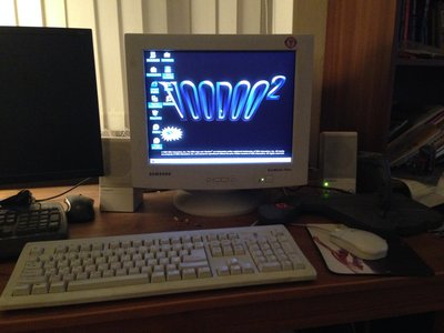

So, here are my current specs:
- Pentium MMX 200, overclocked to 250 MHz;
- 64 MB SDRAM;
- S3 Virge 325;
- VooDoo 2 V-1000;
- Vibra 16XV CT4170;
- 40+80 GB HDD;
- 52X CD-RW;
- 100MB NIC.
I'm sure these specs scream MOAR IS BETTER to the purists among you, but the idea behind the whole huge HDD thing was that I could download a batch of ISOs from my FTP server (another rig) overnight and then burn them to CDs. Besides, I'm actually thinking about giving Baldur's Gate 1/2 another run on this machine and these games just love taking up space. Also, I got a Voodoo 2 because it's cheaper and easier to find than a Voodoo 1.

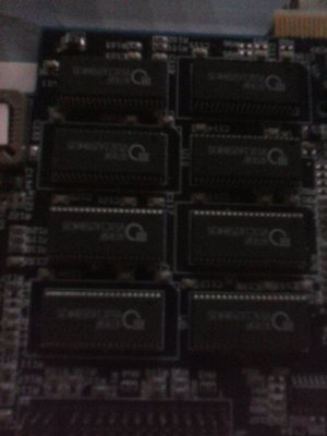

Reply 1 of 19, by jheronimus

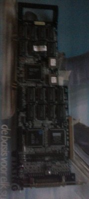

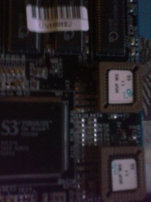

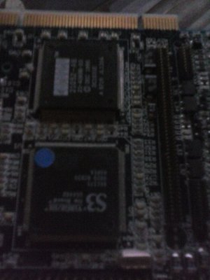

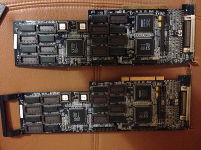

Here's a GPU I could not identify at all.
1.69 MiB
1951 views
These are quad-head S3 Virge cards. Looks like there are at least two S3 Virge 325 chips on each board. They use SCSI to VGA cables! One of them (the one that didn't have a bracket) seems to be fried — it produced horrible artifacts when I plugged it in. It's not practical for me to use these in a build, but I'd like to know that they are.

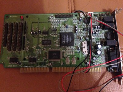

Reply 2 of 19, by jheronimus
This is a Formosa sound card with a SC1620 identifier. Also has a Yamaha OPL chip:

Reply 5 of 19, by Stiletto
STB Systems MVP 3D?

Reply 7 of 19, by jheronimus
Stiletto wrote:
STB Systems MVP 3D?
Tetrium wrote:
Do you happen to know more about these?
I happen to have one (or one very similar to it) but I don't have the adapter, so I can't even test it 🤣
Looks like Stiletto is absolutely right. It has "(c) 1997 STB Systems Inc." written on the board — sorry, overlooked that. The small square white stickers say MVP-3D 1.1 — wouldn't have guessed it's a model name, though.
UPD: Looks like here is a better description:
STB MVP Dual Virge DX graphics controller board - With 4MB EDO RAM for each channel, 170MHz RAMDAC, and one 68-pin high density monitor output connector - Can be upgraded to quad monitor output - Occupies one PCI slot
They were used in HP/Compaq Professional Workstation 5000/5100 series.
Reply 8 of 19, by gdjacobs
Any chance yet to test the ESS cards? For FM sound, you might find ESS emulation to be more pleasant than CQM.
Reply 9 of 19, by jheronimus
Not yet. I'll likely play some Dune 1 soon, so I'm likely to try my OPL-enabled Formoza, too.
BTW, can I use two ISA sound cards in the same system? How do I switch between them? Would just disabling them in Device Manager work? Provided I'm not playing in real DOS, of course.
Reply 10 of 19, by gdjacobs
You can use two cards provided you use non-conflicting I/O port, IRQ, and DMA settings. You can use the same I/O port for the FM synth - FM synth tunes will then output from both cards at the same time. Windows applications can choose the PCM output you would like to use. DOS programs can use either card depending on the I/O port, IRQ, and DMA selected (either by changing the BLASTER environment variable or using the setup program for the software).

I swear that computer (second photo) is like my Acer 486. I don't have the case anymore, but it looked like this one:
Cheers! 😁
Mine has a sticker with "Compaq" on it and there are a few differences with your boards, perhaps it's interesting to compare them for the sake of knowledge 😁
The main difference between your cards and mine is that yours has half the memory chips soldered and the other half are empty memory chip sockets while mine has all memory chips soldered (no sockets) and there are a few other differences like the color of some of those tiny blocks to the right of the "Digital" chip.
And your cards seem to be Virge's where mine has Virge DX's (I packed the card away and the pics aren't very clear *cough* 🤣)
They seem to have the same BIOS versions though, I think mine is a little bit newer revision.
Pics are made with my mobile 🤣

Reply 18 of 19, by Stiletto
It looks like your stickers say "MVP WS", Tetrium... that is indeed another STB model.
STB Systems MVP Workstation
However, the key part number is the Compaq part number, which normally follows a pattern like: 213456-001
do the Fandango!" - Queen
Stiletto
Reply 19 of 19, by Tetrium
Wow...well spotted! 😁
Since you mentioned the other 2 cards were HP (or someone else referenced HP?) and mine came with a Compaq sticker, I reckoned this was important.
Somehow I completely missed the model number written on the tiny square sticker on the BIOS's 🤣
Still very interesting. Too bad I don't have the break-out adapter, can't remember if I ever tried to make it post and hear the beeps though but probably not as I can't use it anyway. I of course kept it as I think it's very interesting (I'm pretty sure I got it for free)
