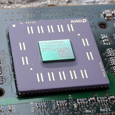

I hoped for a 1000MHz core like my defunct K7 750MHz but I was out of luck. Next time will be my lucky day! 😀 Still, a fresh 8(O)(O) MHZ slot A CPU that enters my collection is nothing to sneeze at.

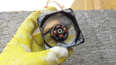

This was the easy part. Next came the cooling fan. Saving cooling fans isn't an exact science or a particularly sure shot procedure. Despite your efforts you might not get the expected results. Even if I am fully aware of this fact I always try to save them. There are two reasons for this: authenticity and money.
I have cleaned quite a few fans over the course of the time and I have a few tricks up my sleeve. In this instance I decided that I need to wash the whole thing with dish soap and hot tap water before I even start to assess its state.
Out with the old bearings! In with the still old bearings! 😁 Despite the washing with water, the bearings still worked nicely so I decided not to open and service them and just give them a grease treatment. I tried to get some grease inside by spinning them or just by using a very fine needle. If you are patient, using a fine needle you can get inside the bearings that minute quantity of grease that is required. Servicing bearings doesn't always get you the expected results. Sometimes they are so far gone that no grease will help. Also, using a thinner or a thicker oil instead of grease usually it is not recommended as it will push the grease out and make the bearing run way louder. In any case, the original grease can became contaminated or even dry out so all in all this is not an exact science. YMMV.
Looking good!

The cooling fan received its final stage of cleaning.
After a day inside the grease bath, I removed the bearings and massaged them until they ran like butter. I think that I got lucky this time or maybe the bearing were of a better quality.

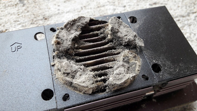

The Arctic Cooling Cooper Silent was full of everything you do not want inside a CPU cooler.

Meet a very dusty double headed monster. A two PAPST beast that I really like! It was mounted on a Slot A AMD 700MHz CPU that in turn was mounted on a very dead Gigabyte GA-7IXE motherboard. When I mean dead I mean riddled with holes. Precious metal hunting + small brains = lot's of dead components. Not all that glitters is GOLD!
Holy dust bunnies Batman!
Dirty bits. In case you are wondering, I powered up the CPU to see if it works. It worked well but I also got a dust storm effect. Like when old plane engine fire up for the first time. 😁 I used a breathing mask of course. The CPU said NOT DEAD YET! AWESOME STUFF! The fans coughed up and got back to life.
Exemplary TIM placement that marginally touches the area of the CPU. NICE! GREAT! AWESOME!

I wanted to service the cooling fans but I found out that they have an enclosed design. I could've tried to try and pull on the propellers and try to remove them as for sure this is the way they were built, with a tiny plastic washer that holds the shaft, but I decided to try something that it is let's say a little more lazy. 😀
Also they were so dirty that there was no way to clean them without extreme measures.
I washed them inside and outside!
Even after a good scrub they were still nasty. In what conditions has been poor thing used? In a mine or something?
After I was done with the cleaning of the fans I used a thick oil to lube the bearings inside. Not ideal but they were in bad shape to begin with. Three tiny holes inside the propeller made things nice and easy. In the end the tiny fans got from a very bad working state to a more than decent one. Still not perfect but perfectly usable if you know what I mean. A small grumble is still present but otherwise they spin freely.
