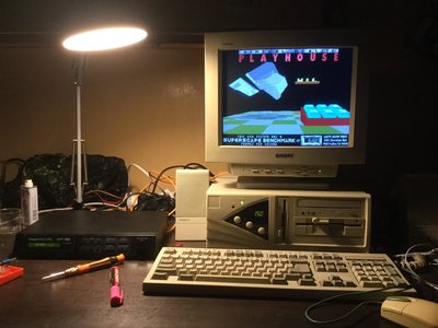

Soooo, it basically took me almost a year to finish this build. Here it is, in all its glory:
1.54 MiB
1234 views
There are still things I need to do, like setting up the turbo LED indicator once I figure out the turbo speed (seems about 486DX@33, btw) or adding a network controller. The 5.25 drive isn't connected, actually — I just didn't have a nice-looking 5.25 bay cover, but I don't think I'll ever use 5.25 disks for data transfer on this system. But other than that it works fine.

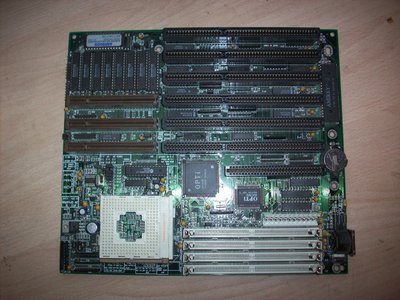

The motherboard I'm using now is QDI V4P895GRN/SMT V1.1.
905.89 KiB
1234 views
It's based on an OPTi 895 chipset. Doesn't support 5x86 natively (so it's AMD DX4 in POST), but it works correctly according to CHKCPU. 4xSIMM72, coin battery, ZIF socket, AMI WinBIOS — I really like this board.

Reply 50 of 57, by TheMobRules
Very nice system, I really like that case!
Regarding the performance: I don't know how fast that Opti chipset is, maybe that is affecting the performance? Also, can you post BIOS settings such as memory timings and all that?

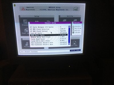

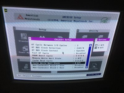

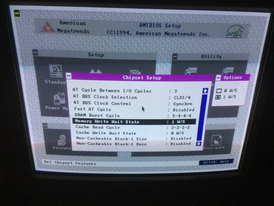

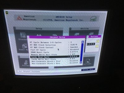

In Chipset Setup, set Auto Config to Disabled and then try tightening those DRAM and Cache timings. I have a motherboard with that same BIOS that defaults to the slowest possible settings when Auto Config is Enabled (different chipset though).

Reply 56 of 57, by jheronimus
What options should I pick? Never done this before

As one user already mentioned - to be able to compare your scores in Doom1.9 to the ones from Anton's complang site you have to decrease the screensize by two(HUD + 1 green border -> 72.2% viewable area which of course is not directly translatable into a 138% speedup). Your score is low even for fullscreen which could prove that the Opti chipset in combination with slow bios settings is killing your framerate.
Regarding waitstates... the lower the better but practicality depends on the quality of the chips used. As far as I remember you're using a 33mhz FSB so the "smallest" settings should be feasible.
Your cache has 15ns(cache+tag) latency which should work up until ~60mhz. With your slow 33mhz bus there shouldn't be a problem... 25ns cache could even be adequate
(duration of one tic for 60mhz fsb -> 1 / 6x10e7 = 10e-7 / 6 -> ~0.167x10e-7 -> ~16.7x10e-9 seconds -> ~16.7ns latency minimum BUT there's always overhead and the tag chip has to be faster).
Overall - try the minimum value and then go up if instabilities arise.
