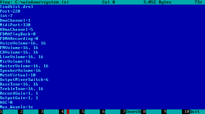

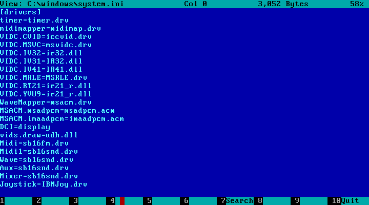

Reply 4 of 22, by Jo22
Oy, that's strange! 😳 Never had such an issue (CT1740 user here)..
Any other suggestions?
If it's only OPL3 related, you could try to install the FM driver manually.
Here are the settings for Windows 3.1, they *may* also work in Win95.
system.ini:
[drivers]
Midi=sb16fm.drv
Midi1=sb16snd.drv
Before you do, make a backup of system.ini.
Edit: Here are the SB16 settings for my Windows 3.1 installation (excpt. midimap.cfg).
I don't know if this hepful, though. Later Windows releases may use registry and different drivers..
Edit: Also found one of my older posts again..
Here's a generic OPL3 synth driver: Re: Getting Adlib General Midi to work in Windows 3.1 on Dosbox

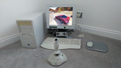

Reply 9 of 22, by Andy1979
Finally, a few photos now that this is up and running.
260.2 KiB
2558 views
Comedy 90s case badge
112.46 KiB
2558 views
Currently I have a 1gb CF card with DOS 6.22 installed, which is working great with older DOS games (Doom, Alien Trilogy, Links LS, Little Big Adventure, Megarace 2) and some DOS Glide games (Tomb Raider, GTA 1).
Also have a 2gb CF card with Windows 95 (retail) installed, which I'm using for OpenGL and DirectX 5 games. This has given me some major headaches as I kept getting Invalid Page Fault errors, seemingly at random. Must have reinstalled Windows at least 10 times, so progress has been slow. Finally tracked this down to being caused by the Intel Bus Mastering IDE drivers. Originally I had no choice but to use these as the Windows 95 installer was disabling the secondary IDE controller (at BIOS level somehow) until they were installed. This turned out to a BIOS bug, which was a problem because I have an OEM board. Followed @voodoo5_6k's advice to flash a 'retail' Advanced/ML BIOS and now the secondary controller works with the default Windows 95 drivers. Disk access is maybe a little slower at times, but the system is 100% stable and plenty fast enough for the games I want to run. I guess it's most likely the CF card not playing nice with the bus mastering drivers.
Astounded at the difference the 3DFX card makes to the system. Games like Quake 2 which are slow and blocky are suddenly playable at VGA resolution with smooth textures and water effects. Forsaken looks absolutely amazing with all the lighting effects - I'd forgotten just how hard that game is!
