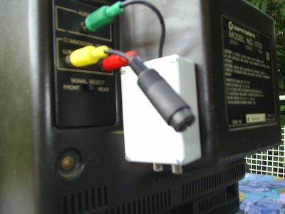

You're right. Because of this, I once built myself an Composite to S-Video adapter for my 1702.
It was essentially the one from Wikipedia. https://en.wikipedia.org/wiki/S-Video#use
I'm afraid it wasn't perfect, though. The old Chroma/Luma ports had a different impedance than modern S-Video.
Edit: Just found some photos. Seems I've also made an S-Video to Chroma/Luma adapter. And an audio mixer, too.

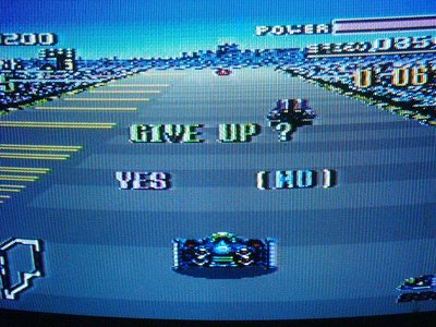

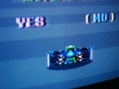

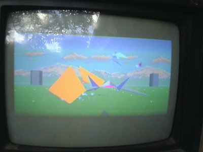

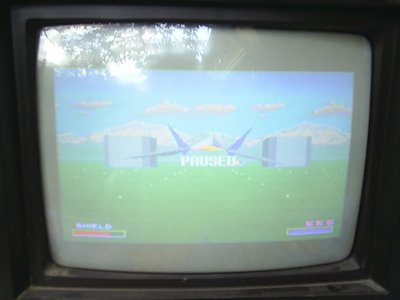

Wait, here are a few photos.. The pictures taken with StarWing used an S-Video connection. Don't know about F-Zero, though.
