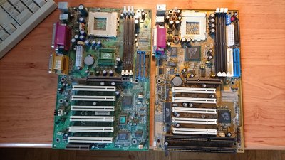

Oh boy, what a day! I am changing window at the attic, and digging through the boxes I found two nice motherboards. One is Epox EP-3PTA which has nice Tualatin support (along with voltage adjustment if I remember correctly), and <surprise, surprise> Gigabyte GA-5AX! I didn't even knew that I have one! 😁 Both are in mint condition and working properly.

Reply 36 of 42, by forteller
Kubik wrote:
ALI - those three letters bring fear and horror to hearts of many... 😀
In case of SS7 you have to chose between them and VIA MVP3 basically (not counting boards without AGP). None of these are without a flaw and both are comparable 😀

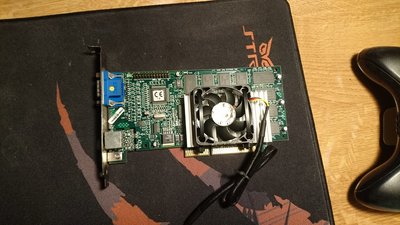

Currently I am investigating why on earth Rayman 2 started to run twice as fast when it "switches" to 60FPS with v-sync turned on. K6-III+ and Voodoo 3 are good enough for just around 50-70FPS with high resolution, so with v-sync on it is just unplayable. It happened all of sudden - I finished half of that game. In the meantime I managed to finish both Evolution and Factory Driver modes in NFS: Porsche. Great game!
I bought second Voodoo 3 - 3000 model this time, and I started to modify it's cooling. What you see on the photo is good for ~185MHz so very poor overclock. I am thinking about one of those orb coolers, because I have one lying around. I missed retro look already with heatpipe cooler 😉
4.05 MiB
1702 views
It has 6ns memories unfortunately, but 7ns on Voodoo 2 2000 were good for 175MHz rock-stable so I was hoping for more.

Reply 39 of 42, by forteller
furan wrote:
Lower is better, this is a latency value.
Yes, I know that, but there were 5,5ns 2000 and 3000 (5,5ns were standard on 3500).
