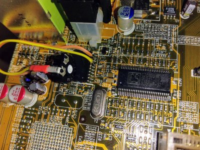

A second experiment with the voltage regulator. This time instead of just getting rid of the resistor going into the FB pin, I put it back in place and created and setup a voltage divider with a 50 kOhm potentiometer I had laying around. The idea: report less voltage/current than is actually being fed to the CPU to fool the voltage regulator into giving us more. Here you see a 1.8 kOhm resistor in the pads where there used to be a 2 kOhm resistor (I didn't have 603 handy, so I used the slightly bigger 805), and a couple of wires going into pin 7 (Feedback) and into pin 9 (Ground).

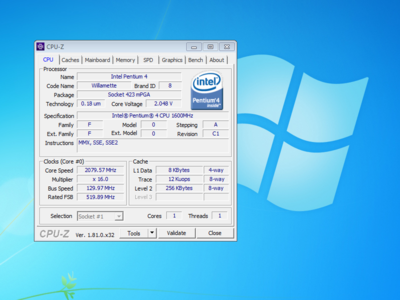

It worked alright as expected, with the caveat that the IC has a safety feature which disallows outputing more than 2 V or so. I was able to boot into Windows at 2080 MHz, but 2133 is still a no go…

The machine seems stable, but the overclocked PCI bus gives the SATA controller a rough time. I will try using a SATA to IDE converter and see if it behaves better.
I could install a similar voltage divider to fool the regulator into thinking its outputting less than 2 V, but I think I'd rather try another CPU first. 2 GHz seems to be where the voltage wall for this one is, I could boot up at 1.77 V and the machine was stable, whereas any higher requires quite a bit more of voltage and is unstable.

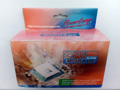

…and a PL-P4/W adapter.
1.37 MiB
478 views
This adapter was sold with a bundled 1.6 GHz Northwood, but it only works with s478 Willamette CPUs. Indeed, I tried it out and it would not work out of the box. I bought it after examining the datasheets for Willamette and Northwood CPUs in 423 and 478 sockets, to see if I could mod it to run Northwood CPUs. Also they are on the rare side, which I get a kick out of. And finally, I also appreciate that it adds to the parallels between this system and my previous build: both are in essence MaximumPC Dream Machine builds (though I didn't intend them to be that), and both use—hopefully, we'll have to see about this one here—adapters to run more powerful CPUs.
Attempting to make this adapter work will be my end of year retro-project—fun! 😀
