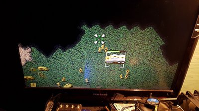

Reply 24 of 69, by agent_x007
Small update : Got myself a proper mouse 😁
234.21 KiB
2134 views
and CnC now works like a charm with sound (CuteMouse and EMM386 are loaded) 😀
229.75 KiB
2134 views

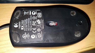

Reply 25 of 69, by sprcorreia
PS2 mice are getting scarce. Recently I bought 5 to have around. 2 of them are Microsoft USB/PS2 and the other 3 are native PS2 from Genius.
Reply 26 of 69, by agent_x007
Yeah that's why I bought two Logitech RX250s (they were listed as "refurbished/used").
Luckily for me, there are plenty of those mice around in my country.
Earlier this year, I bought 5 (five) USB to PS/2 adapters, because I thought they were faulty...
Now I know they all work, and it's my modern mouse (California Access CA-1201 LOMA) that simply isn't capable of using them correctly.

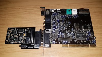

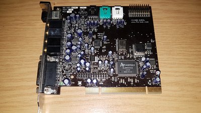

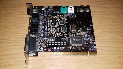

MIDI sound upgrade 😀
"Stock" :
1.12 MiB
1393 views
Upgraded :
A)
1.02 MiB
1406 views
B)
1.09 MiB
1406 views
Question : Is there a difference between A and B ?
Because I'm not 100% sure which is better (compatibility wise) ?
Thank you Serge (aka. dreamblaster) for super fast delivery.
Reply 29 of 69, by gdjacobs
Some daughter cards require the -12V and/or 12V supplied by the wavetable header. The Chill n Phil adapter only provides 5V (which is fine for Serge's stuff). The other rails could potentially be created but would require alteration of the adapter.
Reply 30 of 69, by agent_x007
OK, good to know.
Is there a setup difference between then (like SoftMPU required for MPU-401 adapter but not for Waveblaster header) or are both equall from game/program point of view ?
EDIT : Nevermind.
For MPU-401/Waveblaster to work I only had to modify AU30DOS.ini file with "0" to "1" switch in MPU-401 config line 😀 (X2 was detected automaticly upon restart).
However, Secret of the Monkey Island game needs a MTADL.exe "patch" for X2 to work on Waveblaster header with all sounds playing.
