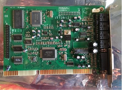

Reply 21 of 76, by Tenorman
A couple of updates:
-I am experimenting with different sound cards in this machine. I can't get the Soundscape to "play nice" no matter what I do. SSINIT hangs when trying to initialize the card about half the time and there is no pattern to it. I decided to put it back in my DX4 100 where it works perfectly rather than keep fighting it here.
-Right now I have a Sound Galaxy Waverider Pro 32-3D PnP (AZT-2320 + Wavetable) installed that I hadn't messed with yet. As others have noted, the PnP configuration for these cards in DOS is difficult. I got all the resources squared away in the Intel PnP utility however and after that I was able to install the card without any issues. It doesn't seem to have any major problems at it sounds decent, but I'm not 100% sold on it yet. I'll probably leave it in for a while and make some recordings before deciding.
249.04 KiB
620 views
-My DVD drive doesn't output audio through the 4-pin connector. I noticed when I looked closely that the 4-pin audio port is labeled "Reserved" and not audio. It was made in 2007 and is probably new enough where they stopped implementing the analog audio out. I need to find a different drive and swap it out.

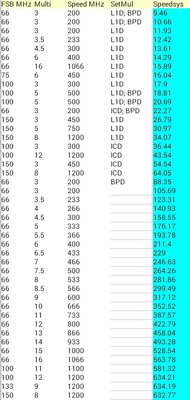

Reply 25 of 76, by j^aws
VIA C3 (Ezra-T) has smoother and wider hardware CPU scaling than P54C/ P55C and K6-III+ (on Super Socket 7). It is only beaten by K6-III+ on a turbo-switched Socket 7.
The flexibility for C3 is dependent on the FSB range available. FSB From 50-133MHz or 66-150MHz gives it a smoother scaling range. Not all CPUs are capable of this range - depends on the quality of the CPU and motherboard. A gentle voltage boost can help the C3 (within 10% spec should be fine). Also, low multiplier of 3 is dependent on the quality of the C3 - not all are capable.
Here's a C3 scaling range for an Ezra-T, 1.0 Ghz and 133 MHz FSB specification, on a 440BX board capable of 150 MHz FSB:
127.57 KiB
545 views
Re: WIP 1: Ezra-T slow-down machine, S370 industrial build...
The scaling benchmark index is represented by Speedsys. You can then correlate other benches from this and approximate actual CPU speeds. You won't get this scaling with P54C/ P55C and K6-III+ (on Super Socket 7). Only beaten by K6-III+ on a turbo-switched Socket 7 build.
