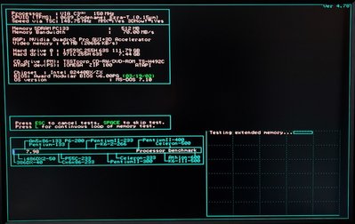

Also, don't know if this is a new record but...
133.5 KiB
432 views
That's right. A 440BX motherboard with an Ezra-T at 50MHz FSB and a 3x multiplier, and stable.

You might be the first one to take a screenshot of it, but not a new record because I've done this before too. 😀
Make sure to add L1D, L2D, ICD, and BPD on top of this for way more slowdown.

I did that. Was you score even lower? 7.9x was the lowest I could get without using any throttling or using BIOS settings.

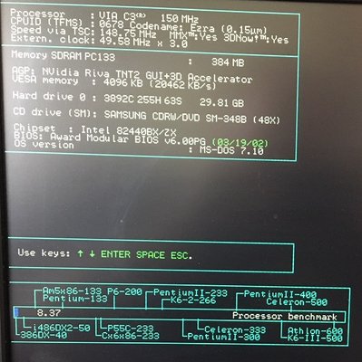

I get 8.37 running at 50 * 3 with BPD, ICD, L1D, and L2D. I could go in the BIOS and start messing with things like RAM timings, but it probably isn't worth the effort.
I also posted my score at 1.0 Ghz for comparison. Quite the range.
Interesting. Considering we're using the same cpu settings, that means your board/BIOS settings combo are more optimized than mine (for top speed).
I'm using CL2 PC133 RAM with optimized defaults, precharge control enabled, delayed transaction enabled.
I wonder if having less RAM might have a positive effect on cache hit accuracy on these CPUs with so little L1/L2 cache.

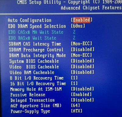

These are my RAM settings. I have not tweaked them manually. I do see that I have Precharge Control disabled and Delayed Transaction disabled.

That's really odd.
Your BIOS settings for CAS latency don't make sense. CAS latency should be either 2 or 3 for SDRAM.
Also, SpeedSys in your screenshots is able to identify your external clock. That line is missing from my SpeedSys results.

Agreed that this is odd. Maybe I will try manually configuring it sometime and see what happens. Either that or reloading the defaults. It seems to work though so I'm not too worried about it.
I will double-check that we are using the same version of SpeedSys later. I am running it in MS-DOS mode, but EMM386 is loaded, so that could also be a difference.
