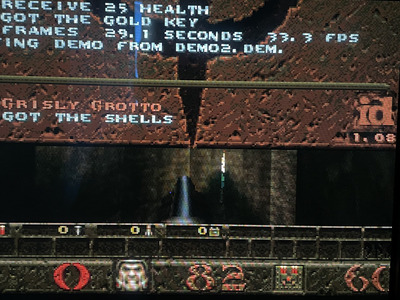

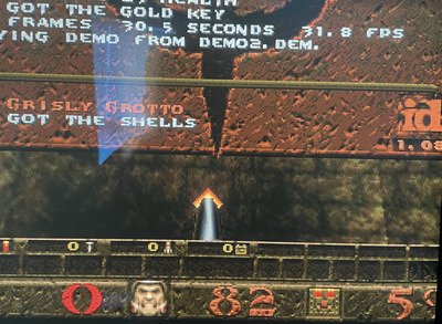

Reply 1240 of 2164, by Chadti99
For anyone interested, the Rendition Verite works on the m919. At the same resolution as dosbench Quake I’m able to achieve 31.8fps in vQuake at 180MHz/1024k L2. Although chalk a couple frames up to vQuake using 1.08 for it’ base.
1.32 MiB
774 views

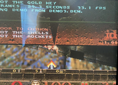

Update!
Forgot to do the jumper FSB trick. With the PCI bus running at a full 60MHz I’m able to hit 33.1 in vQuake! Which I believe is the fastest vQuake score I’ve recorded on a 486.
1.38 MiB
769 views
Update #2
VQuake appears to favor l2 in WB on this board. Im able to hit 33.3 now.
1.2 MiB
765 views

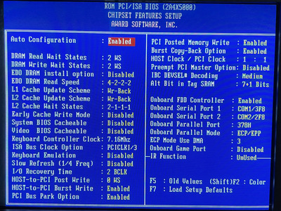

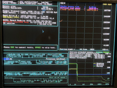

Reply 1247 of 2164, by Chadti99
“Could you attach the Award BIOS for the M919?”
Found it here:
http://th2chips.freeservers.com/syl8884/dwnld.html
Breaks Voodoo4 support but we have some interesting options to play with. It would appear this bios won’t force the pci divider , which is nice.
Edit: confirmed no forced pci divider! Unfortunately dark screen with Voodoo4 inserted. Also confirmed similar performance, still hitting 21.3 in dosbench Quake but with a Riva128 PCI.
Edit2: It also appears to fix the 64MB memory issue with Quake!
Note: the bios settings pictured are not the ones I settled on.
