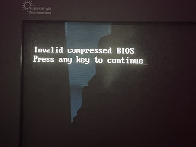

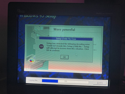

Here’s some of the random stuff I’m seeing now 🤣. Although def related to the voodoo4 at 60mhz bus.

And attempting to install Win95 at 100MHz(25x4).
Reply 1272 of 2164, by Chadti99
Used earlier windows voodoo4 drivers and I can boot into Windows but it’s not consistent, screen will sometimes go black. Tried firing up GLQuake and it went dark.
Also finally tried Voodoo3 and the monitor kicks on but nothing is displayed.
So there is some hope of a Voodoo4 working on this board but I’m not holding my breath, really inconsistent. It also seems to disable my ps2 ISA adapter.
