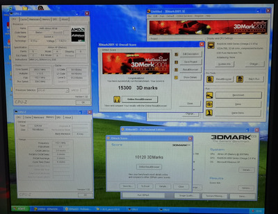

Reply 222 of 346, by Falcosoft
Zeerex wrote on 2022-04-20, 17:11:
I gotta say this thread is a bit amusing, I had this board 20 years ago and it was crash city. It would blue screen all the darn time
Then something went wrong with your board that is not typical.
I have been using this board for 20 years without blue screens 😀
It's worth looking at the OS installation date. It's the original XP service pack 0 and it has been running without problems for almost 20 years:
174.91 KiB
1382 views
Website, Facebook, Youtube
VST Midi Driver Midi Mapper
