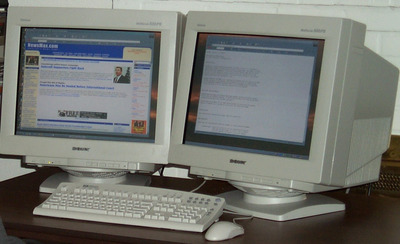

Yes, these HP computers work great. I use to run dual 20" Sony CRTs with a Dual head Matrox G400 or G450 video card. Worked great. Never had any problems. I think I was running Win-2000-pro.
