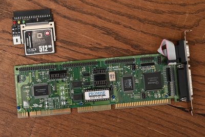

I started to think about which storage option is the best for this build.
The original Promise EIDE2300PLUS isn't at all a bad performer. Is an early period-correct Fast-ATA 2 implementation, it has its own BIOS and dos driver that can tweak it and drive up to PIO2 or MW-DMA speeds.
1.56 MiB
855 views

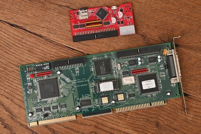

But I picked up this beautiful Adaptec AHA-2842A and given by a kind of exotic nature of this build, thought the SCSI would be a more suitable choice.
1.58 MiB
855 views
Both have a FDC controller which is great. The Adaptec lacks serial port though, but it is nothing a simple ISA card can't fix.
Performance-wise I think the Promise has potential to be a bit faster - this is due to lack of support of synchronous SCSI transfers on the SD2SCSI v5 device I am using. But I might upgrade to v6 at some point...
Which would would you chose?

Got the AHA-2842A working in NexGen.
The "Missing operating system" error was due to the fact that my boot disk is 2GB and apparently the AHA-2842A with existing BIOS can't boot from it.
My AHA-1542CP despite being just ISA has newer BIOS that can handle it just fine.
Resizing the boot disk device to 512MB worked just fine. Once booted to DOS the 2GB volume can be accessed (without any driver), so it is just a matter of BIOS boot support.
As for speed, it is noticeably slower than the Fast ATA-2 Promise controller. Only about 1200kB/s reported by Checkit. The promise is about 3-4x faster. I will have to experiment with cards/settings.

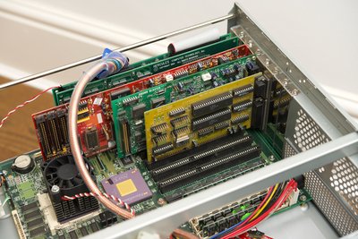

The system got the SCSI upgrade. In terms of performance it is a downgrade mainly due to slowish SCSI2SD 5 device.
1.25 MiB
725 views
I have two ISA slots left 😀. One will be taken by a network card. Still deciding on the model. I am actually thinking building a retro Token-ring or 100VG-AnyLan retro home network.
Also need to sort out cabling mess. I like the idea of placing ribbon cables under the board so that the interior of computer is tidy looking.
