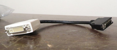

If you are looking for DVI on a PCI card that works on a 486, you may want to consider using the Matrox G200 with the MDR-20 flat panel add-on connector. You can then use a MDR-20 to DVI cable adaptor. This is what I've done on my IBM 5x86c-133/2x system.
