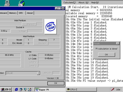

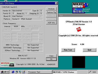

Reply 20 of 30, by Ponjiayulady
Pentium 66Mhz performance test
    68.57 KiB
    650 views
    cpumark
    89.58 KiB
    650 views
    Pi 1M
    83.49 KiB
    650 views

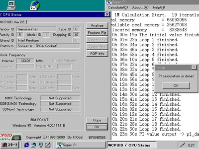

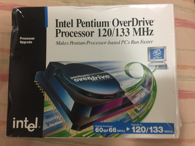

Reply 21 of 30, by Ponjiayulady
Socket 4 Pentium Overdrive original Box
1.14 MiB
649 views
POD 133Mhz Box

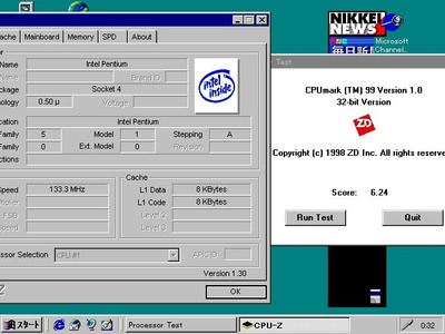

Test
62.57 KiB
649 views
cpumark
104.33 KiB
649 views
Pi 1M

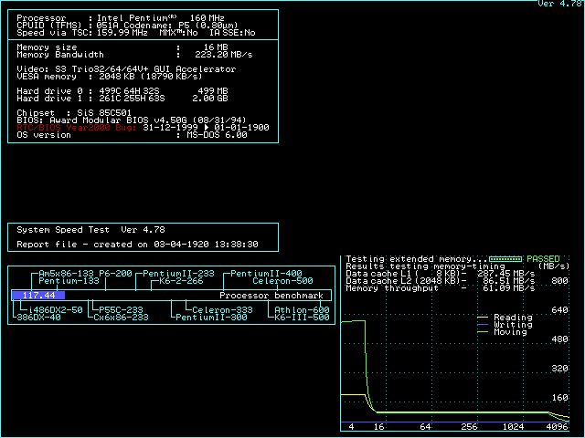

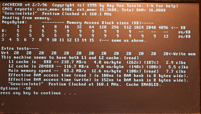

Reply 26 of 30, by mpe
The performance of this system has been great so far.
I was thinking about how to tune it even further. Then I found a datasheet of the clock generator (MX8315) with undocumented 80 MHz FSB option.
72.87 KiB
532 views
Obviously, 80 MHz is is too much for old 5V 60/66 MHz CPUs. However, it surprisingly works with more efficient PODP5V133. The 160 MHz CPU, 80 MHz FSB and generous 2MB L2 cache really gives this system wings. A Socket 4 system with asynchronous L2 can now compete even with much more modern 150/166 MHz Socket 7 systems with Intel Triton chipset. Even with more conservative 3-2-2-2 L2 timings.
