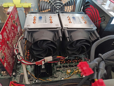

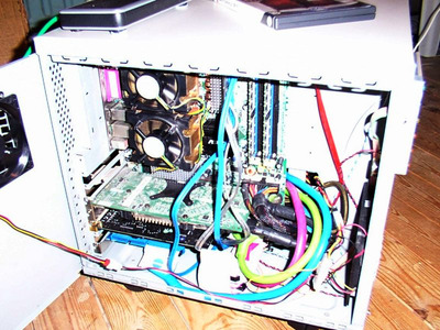

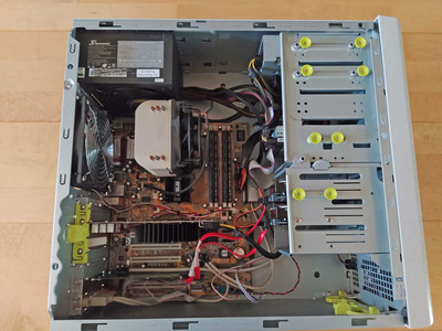

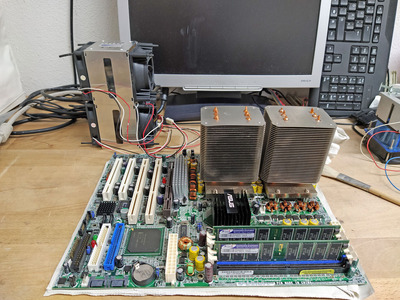

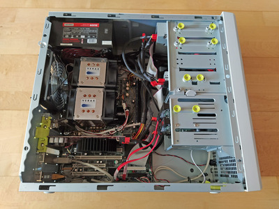

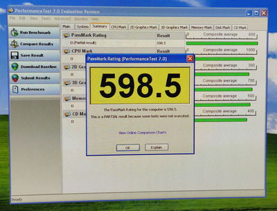

Hi there,
I really created somewhat of a monster 😉
This is my latest 2004 built and it is hot - in fact too hot and I disassembled it some days later 🙁
Board: Asus NCCH-DL, Dual Socket 604, Intel 875P Chipset
CPU: 2x Xeon SL7TB (Nocona), 2.8 GHz, FSB 800, Hyper-Threading, TDP 103W, Socket 604
CPU-Cooler: 2x Verax X20, Socket 603/604, 3x 6mm Heatpipes
RAM: 2GB (1x1GB), ADATA DDR 400 (PC 3200), CL 3, ADBGC1A16
2D/3D: Palit XpertVision ATI/AMD Radeon X850 XT, 256 MB GDDR3, AGP 8x
Sound: ADI AD1980 SoundMax (Onboard)
HDD: Raid 0, 2x 250 GB Sata HDD, Seagate Barracuda 7200.9
ODD: DVD Multidrive, LG GSA-4120B, IDE
ZIP-Drive: Iomega ZIP 250, IDE
Case: InWin IW-C588
PSU: Xilence XP600, 600W, active PFC, ATX
OS: Windows XP Professional SP3
Unfortuately the dual Xeon need a lot more breathing space that in that case and it ran constantly hot when the case was closed.
Plus the two Verax fans don't just look like tubines, the also sound like in the small case.
This combo needs a way biger tower case with several fans to aid the airflow.
So I slaughtered this monster and will put in a P4-HT instead - this specs will follow soon.
Have fun 😉

Reply 3 of 19, by pentiumspeed
Never mind! Verax fan was reviewed and people tried them and they performed poorly no wonder I heard very little about them, remember I was searching for quiet solutions to my noisy PC was Athlon PC back in the day. Even ebay has only one verax heatsink just now, using regular fan, plenty of information on google back in the day when verax were tried out. Ended up built my own adjustable voltage regulator on a card attached to a bracket taken from old card.
Ignore this:
You realize that funny thick fans in front of these two heatsinks are blowing out forward instead of into heatsink? Turn these heatsinks around so these oddball fans blows towards rear panel and flip the thinner fans to blow into the heatsinks.
My funny story:
I had a customer come in few months back, saying hot, His liquid cooling radiator fans sandwich was blowing into radiator both sides. Simply flipped one fan around to move in one direction fixed it.
May have to change these heatsinks to Nocta, what I like to look for is thick fins, more spacing between fin to fin than normal so only needs low pressure, high flow to keep noise down.
Good cases always have 2 equal openings: intake and exhaust surface area and your does not meet that hence hot.
Also that exhaust fan blades is not broad enough to generate pressure while kept quiet.
