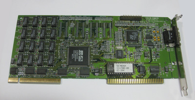

I ended up with the S3 968 because it is 4 MB capable more than any other reason. I have two desks in the office, both of which have 17" LCD's native at 1280x1024. So when I pull the 486 out of the closet for the occasional tinkering, I want the display to look sharp, meaning to use the native LCD's resolution. While you can do 1280x1024 at 256 colour and 2 MB, the 8-bit colour depth is too much of a sacrafice for my taste. I also have a slight preferance for Windows GUI and niche MPEG-1 decoding over absolute maximum DOS speed. If there was one card which did it all, I'd use that one.
I think there is one other VLB card which can accommodate 4 MB of RAM. I'm pretty sure it is the ATI Mach64, but if the ISA counterpart is any indication, the DOS speed will be falling behind the competition. There should be an ATI Mach64 card which has a connector for a 2 MB expansion module. Unfortunately, mine is 2 MB only without a connector, but there are unpopulated SOJ sockets. Maybe someone knows if I solder on the missing memory, resistors, and caps then it will work at 4 MB?

Hard to tell. My guess is that these unpopulated sockets are not for upgrade, but rather the PCB was designed for alternative memory RAM chip configuration (4bit or 16bit). The only way of telling would be to investigate how address RAS/CAS and address lines are wired. There is a register in Mach64 where you can query memory configuration. It is either DRAM 256Kx16 or DRAM 256Kx4 (or VRAM configurations), but not a mixture of types. That makes me thing your card is 2MB max...
However, even with 4MB I don't think that the STG1702 RAMDAC would support 1280x1024 with more than 256 colours.

This sounds familiar. I had investigated this some years ago and determined that I would also need to swap the RAMDAC. There are pads for different RAMDACs. I also suspect the SOJ pads are for either/or, and not both.

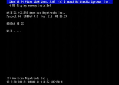

@feipoa Curious if you get this blue post message with your 968? Not mine, found on YouTube. It’s not something I see on my setup.

The VL/I-486SV2GX4 does show that blue Diamond bar w/968, but only briefly on a hard reset. Press the reset button and don't blink.
