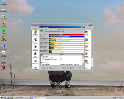

CPU: Intel Pentium E6800
Highest single core performance without overclocking that this board supports. This motherboard's FSB overclocks pretty poorly, and an X6800 can be expensive. A QX6800 would automatically downclock my motherboard's FSB by 5%, but since I'm only using one core I could feasibly raise the FSB back up, and get that sweet 8MB cache. For now this is what I settled with. With a pretty small TDP, I have an ARCTIC Freezer 11 LP CPU cooler. With only a single core ever active the temps are very low, around 50 60 C, even when running Prime95.

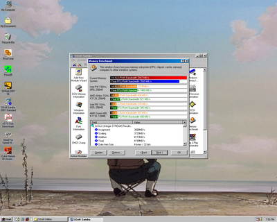

RAM: 2x256MB Kingsto​n KVR667D2​N5/256
In an effort to avoid patching, I'm sticking to 512MB of RAM to keep it kosher. They're actually clocked to 533MHz (1:1 ratio) since I read that this chipset's memory controller seems to prefer 533MHz over 667MHz. Haven't gone too deep into optimizing the memory timings yet.
Side note: 256 MB sticks of DDR2 are hard to come by these days.
Edit: Timings are now 3-3-2-5 tRFC: 15T CR :1T 4-way interleave @ 576MHz.
Edit 2: Previous timing was slightly unstable. Loosened to 3-3-3-5 fixed it.
Alt. RAM: 2x1GB A-Tech DDR2 PC-5300 667MHz
Timings: 3-3-3-5 tRFC: 21T CR: 1T 4-way interleave @ 576MHz.

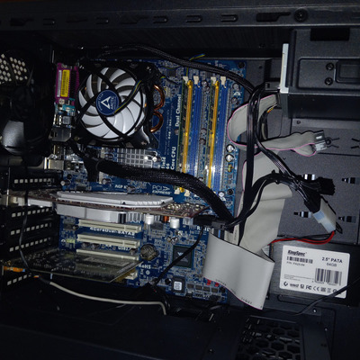

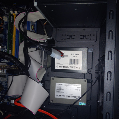

Storage: 64GB KingSpec IDE SSD
Another technical oddity in this build. Apparently these were made for some high end ThinkPads back in the day. Mixed reviews online about their reliability but so far it's been working great. All the benefits of an SSD without messing with SATA patches or a PATA to SATA converter. All I needed was a special adapter to go from the slim laptop IDE form factor to the regular desktop form factor. 64 GB to keep it a kosher as possible with 98's installer. Sadly the adapter I have has a 40 pin ribbon cable instead of an 80 pin so I'm losing out on a lot of bandwidth. I've ordered a different adapter that doesn't include the ribbon cable already attached. Once I get it I'll post benchmarks.

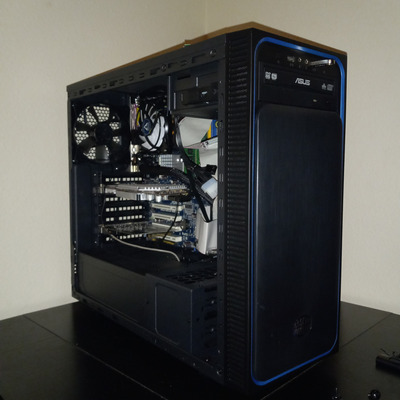

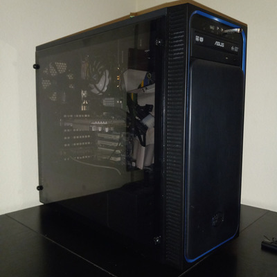

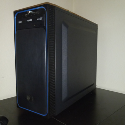

Case: Cooler Master MasterBox E500L
Not a lot to say, other then it looked kinda like a retro-futuristic late 90s computer case. I think it looks awesome, and unique amongst the army of black monolith style computer cases we have now. The 2 front USB 3.0 ports are wired to the motherboard with a 3.0 to 2.0 adapter. Both ports work perfectly.

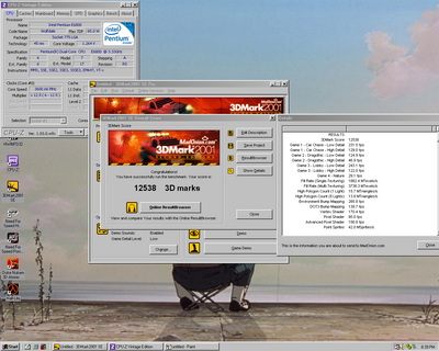

Benchmarks!
I know you want them. I'll run more once I dial in better memory timings and higher clocks on the CPU and GPU. I'll also post hard drive benchmarks once I get an IDE adapter that supports an 80 pin ribbon cable. For now this is what I got.
3DMark 2001 SE (CPU: 3.60GHz, FSB: 288MHz, RAM 576MHz 3-3-2-5 CR:1T, GPU 520MHz Core 1015MHz VRAM. (AGP Memory Bug)
file.php?id=124281&mode=view

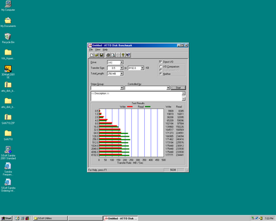

ATTO Disk Benchmark (64GB KingSpec IDE SSD SM2236 Controller)
file.php?id=124809&mode=view

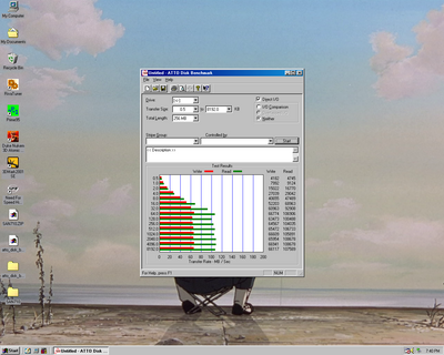

ATTO Disk Benchmark (128GB Crucial m4 SSD 2.5 in RAID mode)
file.php?id=125154&mode=view

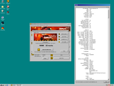

3DMark 2001 SE with GeForce 7950 GT
file.php?id=147176&mode=view

Reply 1 of 106, by BitWrangler
That 3DMark seems under half what it should be, I was getting better than that on Socket A. Unless FX5950 really does suck that bad on DX8, I'd have been running a Gf4200 at somewhere near 4600 clocks.
Edit: dang "nature" particularly slaughtered it, I was in the 30s with a GF3

New benchmark and tightened the memory timings (3-3-2-5 tRFC: 15T CR :1T 4-way interleave)+ overclocked the FSB to 288 (highest it could go before P95 failed while keeping the tight timings), memory is now at 576MHz and CPU is at 3.6GHz. MemTest86 passes with no errors. Still finding how high this 5950 can clock to, but it passed 3DMark 01 with 520MHz core and 1015MHz VRAM.
Spoiler
670.51 KiB
4414 views
This bench seems to fit better with what you'd expect out 5950. If I had some better RAM I could probably get 3-2-2-5 8-way interleave, but I'm just chasing maybe a few percent performance gain at that point.

Still at a loss as to what is causing this performance issue. Disabling the USB controller on the motherboard did not help much (+200 points on 3DMark01). Though I fixed my USB gamepad lagging issue by upgrading NUSB from 33E to 36E. I tried the 45.23 based Omega driver, no change there either (Slightly slower in the Nature benchmark). Fiddled with more BIOS settings but no big changes. I ran Sandra 2001 CPU and RAM benchmarks and got these scores, I don't have anything to compare it to though. Is this about what an E6800 should be pushing?
SiSoft Sandra 2001 (CPU: 3.60GHz, FSB: 288MHz, RAM: 576MHz 3-3-2-5 CR: 1T

Some good news at least, I installed a "Sabrent Laptop 2.5" to Desktop 3.5" IDE Hard Drive Adapter" (as B&H Photo calls it) so I could use an 80-wire IDE cabled with my IDE SSD. It works perfectly! I have full UDMA-133 speeds now. ATTO benchmark:
ATTO Disk Benchmark (64 GB KingSpec IDE SSD SM2236 Controller)
745.92 KiB
4016 views
Reply 18 of 106, by Baoran
Not sure why exactly but I tried running 3dmark01 with 45.23 driver and it dropped score from 18588 to 16293, so it does not seem like 45.23 version is fastest driver at least for 5950 ultra and 3dmark01.

Still no luck on getting this performance issue solved. I re-imaged the computer and tried it with no SB drivers installed, no difference in performance. Made some improvements to the hardware though!
I know it's mounted on the wrong side, the IDE cable doesn't fit mounted when on the back.

I installed a SATA SSD to install Windows XP on. I'm trying to make it so that I can use 98 with the SATA drive still plugged in. Just plugging it in and leaving it on AHCI mode will give the 'ol
Your multi-function device (Standard Dual PCI IDE Controller) has some child devices using 32-bit drivers and others using compatibility-mode drivers. This configuration is not supported, so your computer has been halted to prevent corruption.
blue screen message, and breaks CD drive functionality.
Setting the SATA controller to RAID mode causes 98 to hard lock as soon as the splash screen displays. Fortunately, I narrowed this down to EMM386.EXE and RAID not playing nice with each other. If I boot without EMM386, it works. If I boot with the SATA cable unplugged and EMM386 enabled, it works. I'll have to tweak CONFIG.SYS (any tips would be helpful, DOS was before my time) to get it to work properly. With RAID mode working in 98, and the VIA RAID driver installed, I was able to create a DOS partition and format the 128GB SSD to be usable in 98. Even though I don't intended for 98 to ever touch this normally, I wanted to see how well it performed.
37.12 KiB
3865 views
I was worried that the RAID controller would cause some bad I/O performance, but I guess that's not an issue! (queue the comments telling me that's half the score I should get) I want to get to get some wrapped IDE cables to clean up the interior a bit but cosmetic purchases are on hold.
