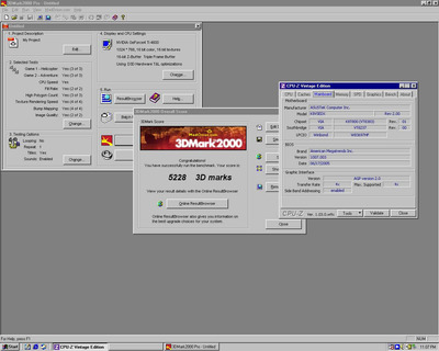

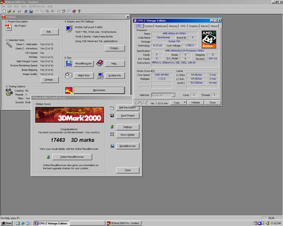

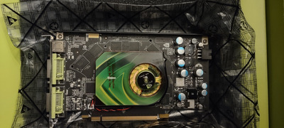

Reply 86 of 105, by VDNKh

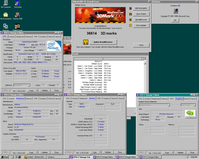

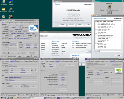

The AGP issue has been on the back burner for me, but I have some other goodies to present. Picked up a cheap new-old stock XFX GeForce 7950 GT off of eBay. They are still available too.
Spoiler
1.2 MiB
1009 views
After changing the BIOS setting to default to the PCIe port for graphics, the card is 100% functional. (I didn't even reinstall 98)
Benchmarks in 98: GPU Core: 570 MHz, GPU Memory: 730 MHz
143.38 KiB
1010 views
115.62 KiB
1010 views

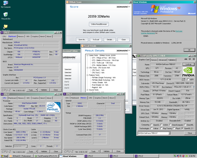

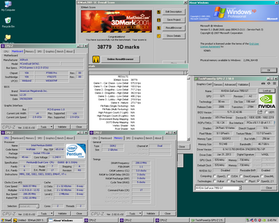

This is a 512 MB video card and I initially had only 512 MB of RAM installed. RLoew's NVSZ patch could cut the VRAM down to 256 MB but I wanted the full 512 MB. So I installed 2 GB of RAM, Unofficial Nvidia 82.69 display driver, RLoew's PATCHMEM, as well as his NVSZ VBIOS patch to expose all 512 MB of VRAM to Windows. It all works perfectly. I also had to lock the PCIE bus clock to the CPU and disabled "PCIE Downstream Pipeline" and "PCIE VC1 Request Queue", under the chipset settings, to get the GPU to work properly.
I haven't tested many games yet, but System Shock 2 and Half-Life work almost perfectly. Half-Life has some small corruptions on some of the walls, it looks kind of like z-fighting, but I hardly notice it. 98 itself is perfectly stable with no corruptions in the GUI.
Thermal paste seems to have held up well in storage, highest temperature I recorded so far was 89 C in 3D Mark 03. No re-paste necessary.
And unlike the AGP port, the PCIe port performs almost the same between 98 and XP.

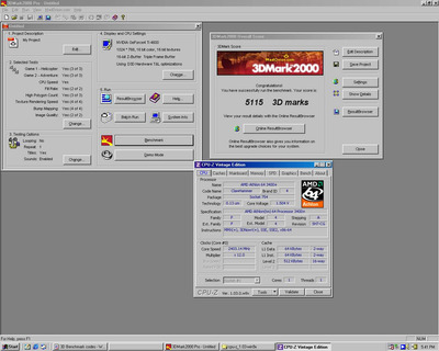

Benchmarks in XP: single core affinity
184.75 KiB
1009 views
141.12 KiB
1009 views

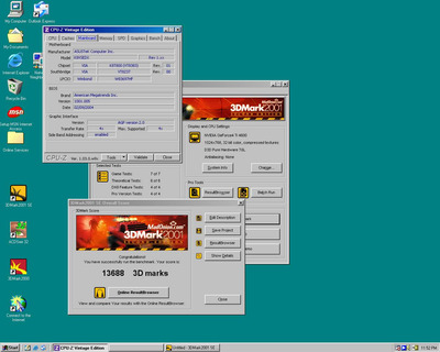

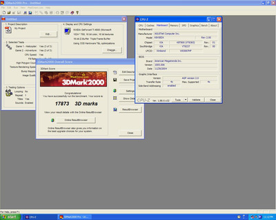

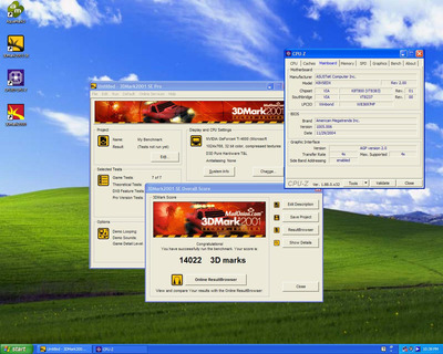

Reply 91 of 105, by deksar

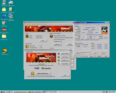

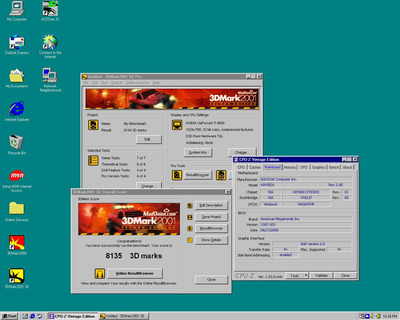

Hi, okay, just wanted to try as VDNKh informed me about this post, under my own post, and I think I have the same bug.
But it was disappeared after downgrading the BIOS, from 1009.008 to 1005.
Here are the screenshots;
3DMark01: Before downgrading the BIOS, total AGP memory was: 0 bytes.
3DMark01: After downgrading the BIOS, total AGP memory is as shown above.
GPU Card Properties Window: Current AGP Speed: was Disabled, it's now 8x Enabled after downgrade.
Dxdiag: "AGP Texture Acceleration" was Disabled, it's now Enabled after downgrade.

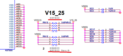

Reply 99 of 105, by shevalier
bloodem wrote on 2022-08-22, 05:36:
Now, here comes the kicker: I have (what appeared to be) two identical K8V-X SE motherboards - same revision and all. However, only one of them worked with the old K8V-X BIOS versions, the other failed to POST after the BIOS update (froze at a memory related post code). So I took off the north bridge heatsinks, and lo and behold, even though both motherboards look identical, their north bridges certainly are not (the North bridge with the round, grey metalic area appears to be a newer revision).
When I was looking for the reasons for the instability of the AGP Radeon with the REALto bridge, I came across the schematic of the ECS K8M800 motherboard.
Yes, there are two revisions of the K8T800, which differ in the supply voltage of the core logic - 1.5V or 2.5V.
I have revision B, which all utilities define for some reason as K8T800 PRO
the North bridge with the round, grey metalic area appears to be a newer revision.
If that's important to choose from, then the package with the metal heatsink is an old revision of the bridge.
Completely plastic - new revision.
    34.48 KiB
    122 views
