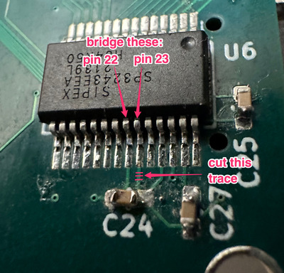

I also couldn't get a serial mouse to work (Logitech M-C43). The mouse works on another computer. I did successfully use the TinyLlama serial port for bios debugging and also from DOS with a nullmodem connection to another computer.
Tried several mouse drivers (cutemouse 19, 20, 21 and logitech drivers), tried to disable the BIOS USB mouse support, no luck.
I noticed that the MAX3243 (RS232 transceiver on Tinyllama) spec sheet has a few paragraphs about driving serial mice. It does say that the auto power down feature should be disabled for serial mouse support. I didn't try to change this, not sure if it could have something to do with the problem.

This might very well be the cause, yes. Good catch! I knew I had successfully tested serial mice (albeit with a raspberry pi emulating a serial mouse) sometime in the past, using the MAX3243 - so I was confident it should work. Going back to the schematics of that early 2019-prototype, I see now that I'd included a pin jumper for the FORCEON feature of the 3243:
237.79 KiB
1159 views
GPL-2.0-or-later
...which would explain why it worked then, but doesn't seem to work now. I assume TI knew what they were talking about when saying the auto-powerdown should be disabled for serial mice.
If anyone wants to give it a shot, try cutting the trace between pin 23 (FORCEON) and GND, and bridging pin 23 and pin 22 (~FORCEOFF, which is tied to VCC), thereby pulling pin 23 high:
709.85 KiB
1159 views
GPL-2.0-or-later
I'd be very careful, though, as not to accidentally bridge VCC and GND 😉

Reply 163 of 661, by Eivind
florian3 wrote on 2022-11-07, 21:59:
I lifted the pin and bridged it, still not working.
Could it be a uart configuration issue? I'm really not that familiar with serial mice, but I think they might usually be communicating at 1200 baud, right? I don't know if CuteMouse or the Logitech equivalent will try to reconfigure the computer's uart to that speed, but if not - try doing that manually? MODE COM1: ...something...?

Reply 168 of 661, by tabm0de
Eivind wrote on 2022-11-07, 20:36:
This might very well be the cause, yes. Good catch! I knew I had successfully tested serial mice (albeit with a raspberry pi emu […]
florian3 wrote on 2022-11-07, 19:38:
You lucky it wasnt a fix, as i already have my boards with the other "fix" ( if it is a fix that is, time will tell ) 😜
naa, nothing yet...
Reply 169 of 661, by rasteri
Serial mice are weird - they typically have no charge pump to generate RS232-compliant voltage levels. So they require negative, positive AND ground voltages to be present across various pre-defined serial pins that vary depending on device manufacturer. I'm not sure how cutemouse handles all the different possibilities, but back in the day you had to use the driver that was specifically written to cope with that specific mouse otherwise the voltages would end up on incorrect pins. Maybe that's what's going on here.
PS/2 to serial adapters are also very manufacturer-specific - the generic ones you find on eBay don't work on ANY of my PS/2 mice (even the ones that say they support serial).
(interestingly, most of the serial mice I've checked actually use the serial port's negative voltage as VSS, and GND as VDD. Probably because this allows for simpler low-side logic switching).
Reply 170 of 661, by Eivind
rasteri wrote on 2022-11-08, 11:40:

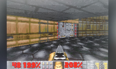

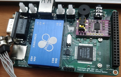

Reply 171 of 661, by Deksor
Today FedEx came in early (I expected them tomorrow but they came this morning so that's great)
1.23 MiB
1003 views
And it works first try 😁
1.08 MiB
1003 views
Now there's a minor inconvenience, and I'm not sure if it's a hardware issue or software issue : when I first set the card and doom to irq 5 I had no sfx, but the opl3 music worked. However by setting irq 7 sfx started to work just fine.
The doom version I tried is quite old (v1.2) so it might be just a quirk with this old version of doom, I haven't tried anything else yet (I'm using the usb drive used to flash the bios).
Another thing I noticed is that there seem to be a high latency with the keyboard. Again maybe it's something wrong with my setup and everything should be fine otherwise, but as usb can be pretty demanding for low end devices, I'm not certain of this.
I'll try to make more tests for this later 😀
(I could even make my own latency test program and use a crt for minimal delay)
Reply 172 of 661, by Eivind
Deksor wrote on 2022-11-09, 10:04:
Yay! Good to hear! 😁
Yep, use IRQ 7. I think I already wrote that in the configuration example in the wiki.
There's bound to be a certain amount of lag with USB keyboards since the BIOS is just polling USB events periodically and then translating them to PS/2. But I'll double check that there are no unnecessary slowdowns in the code, logging or anything else going on there. Hopefully later today/tonight, I just got a few serial mice in that I'll check out as well.
Reply 179 of 661, by Eivind
I got hold of 4 serial mice and did some testing. Only one of them worked with the 3243 in auto-powerdown mode. After turning that feature off by doing the pin shenanigans described earlier, they all worked. Although - only after running COMTEST. I'll have to get back to that later, did some initial probing around with DEBUG, but nothing solid yet.
So yeah, my take on the auto-powerdown issue is that it's happening too fast for most mice to manage to send anything back before the 3243 kills the DTR/RTS lines powering the mouse.
