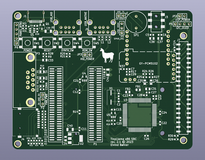

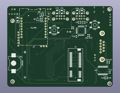

While I'm waiting for the 16.9344 MHz crystal to arrive at JLC's warehouse, here are a couple of screenshots from KiCad of revision 2.1:
Looking forward to its successful test and release! 😀
Is it really 2032??? 😀 a lot nice since you can grab them even at local stores 😀
