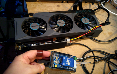

Tried a RTX3080, heh. Looks hilarious next to the vortex86EX 😀
1.28 MiB
1304 views
Here's the updated chart :
            PCIE Vortex86VGA    PCIE Quadro FX1700    PCI Virge DX    PCIE RTX 3080
DOS DOOM 27.0 60.6 57.1 60.1
DOS Quake 27.3 32.8 32.7 32.8

Reply 330 of 661, by rasteri
My SM750 arrived just as I was testing the RTX!
It's the new winner in both benchmarks! Looks like a great option.
            PCIE Vortex86VGA    PCIE Quadro FX1700    PCI Virge DX    PCIE GTX 3080    PCIE SM750
DOS DOOM 27.0 60.6 57.1 60.1 62.9
DOS Quake 27.3 32.8 32.7 32.8 32.9
Eivind wrote on 2023-01-07, 17:16:
Remind me again, what's your setup for these tests? Mini-PCIe-to-PCIe (1x) adapter for the PCIe cards?
yup!
For the PCI Virge DX, which PCIe-to-PCI adapter did you use?
It's a dual-slot unit, based on the ASM1083. Got it here - https://www.aliexpress.com/item/4000386897167 … .1f221802V9OSuM

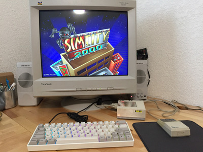

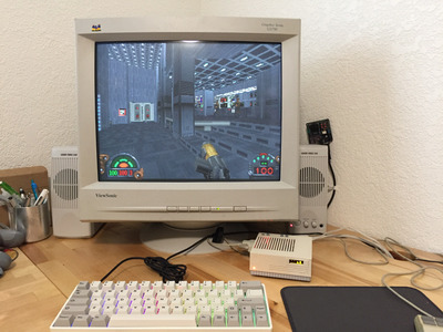

Reply 335 of 661, by Aaron707
Finished making a case for my board. Posted the files here https://www.printables.com/model/362273-tiny-llama-x86-case if anyone wants to modify it or print. Huge learning curve figuring out 3D printing and cad but it was a fun journey. I can just play SimCity 2000 for hours on this thing. It sounds great with MT-32 music. Also some Star Wars : Dark Forces for good fun as well. Both serial mice I tried worked out of the box. I think the biggest thing needed is some sort of joystick or gamepad emulation or translation to be perfect. But overall it does everything very well and is an awesome little machine.
    1.33 MiB
    1231 views
    1.31 MiB
    1231 views
Reply 336 of 661, by Eivind
Aaron707 wrote on 2023-01-07, 23:35:
Fantastic!
I'm actually picking up a couple of rolls of the Jessie filaments from the post office on Monday (got an American colleague to ship it for me), hoping to make such a nice case as yours! 😁
