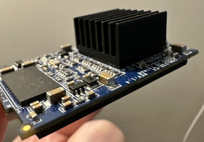

Reply 408 of 661, by Eivind
tabm0de wrote on 2023-02-14, 13:34:
Throwing out a question regarding heat sink, have heatsink on the chip and remove the "blue" heat sink that it comes with or just putt heat sink on top on the blue one. What could be pros and cons depending the way to go?
Underneath the blue 86Duino heat sink/shield, there's a fat thermally conductive pad between it and the CPU. If you want better thermals, just remove both of those and put a proper heat sink with a thermal adhesive double-sided tape on the CPU instead. There's also a RAM package on the SOM, but it doesn't get hot and doesn't require cooling.
Here's a photo:
577.45 KiB
1886 views
I used a simple little aluminum heatsink from Digikey.

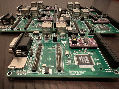

Reply 410 of 661, by Eivind
A few llamas herded together, waiting to be shipped out:
1.78 MiB
1783 views
