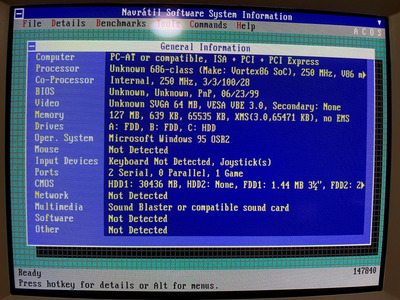

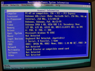

Reply 443 of 661, by Aaron707
Eivind wrote on 2023-03-06, 23:27:
Aaron707 wrote on 2023-03-06, 23:22:
I will try it later tonight hopefully, need to setup a linux machine or VM to compile the BIOS for my V1.1 board.
I'll build it and DM you. Don't want it floating around here as it'll render systems with the Vortex86VGA module useless.
Thanks for the BIOS! Unfortunately it did not resolve the issue. Quake and Duke both freeze at 640x480. Not that I need to play them at those resolutions anyways. Maybe the DOS compatibility of the ASPEED isn't very good after all.
So I was wrong about the VGABIOS being the issue. I was also able to use NSSI dos information utility to dump the VGABIOS when VortexVGA card was installed and the ASPEED. Both look like they have the right information to me after all.
    1.19 MiB
    1519 views
    1.33 MiB
    1519 views
    VGA BIOS dump.zip
    36.71 KiB
    45 downloads

Reply 445 of 661, by Eivind
Aaron707 wrote on 2023-03-07, 00:22:
Just verified that Quake works at 640x480 on the SM750. However, it's running at single-digit fps so basically useless. Like I've said many times before, the Vortex86EX/TinyLlama is just not suited for medium-to-high-res games.

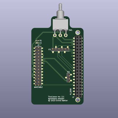

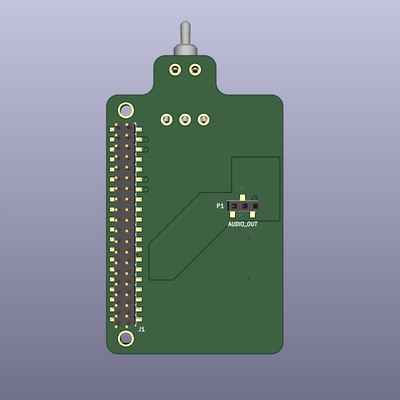

Reply 456 of 661, by Eivind
@RayeR: Thanks! 😀
@Aaron707: I whipped up a design for the wavetable adapter, this has room for both the pi zero 2 + the GY-PCM5102 module and the wavetable board.
Added a switch to toggle between them. I haven't received the actual S2 to test with yet, but here's where I'm at:

Reply 457 of 661, by tabm0de
Eivind wrote on 2023-03-08, 11:26:
@RayeR: Thanks! :) […]
@RayeR: Thanks! 😀
Nice, just a stupid question will two of GY-PCM5102 be needed or is it moved from the board to the adaptor?

Reply 458 of 661, by Eivind
tabm0de wrote on 2023-03-08, 15:40:
You'll need to desolder the gy-pcm5102 from the main board and add a fresh 3-pin connector, as that's where the adapter's analog output connects to the main board's analog midi-in.
