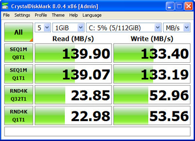

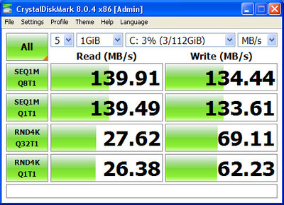

CrystalDiskMark looks good for an IDE mode SATA-150 interface and a small low-end drive like the UV400. Moving the starting sector from 63 to 2048 improved random I/O a fair bit. We'll see about FAT32 and 98SE when we get there.

NTFS, XP, default partition alignment.

NTFS, XP, 4K optimized partition alignment.
