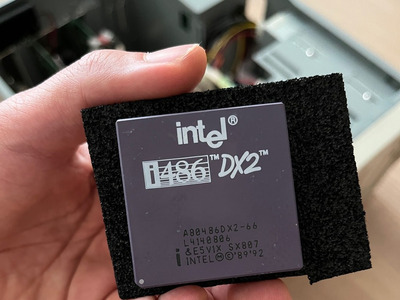

Well... summer break is over, time to get back to fixing this thing.
...so I got the other major upgrade, which is the DX2 66 MHz chip. This one was at a premium on eBay, but I figured I'd make the upgrade sting less by selling the older DX rather than keeping it to reduce the cost of the upgrade.
124.09 KiB
1397 views
Intel A80486DX2-66 SX807
I pondered for a while about the cooling solution and mounts, then finally settled on Alphacool Double-Sided Adhesive Pad. This would allow me to mount a small heatsink atop the CPU without worrying about pins and clips and those kinds of horrors. I just wasn't sure how well the CPU would cool.
After waiting for a day for the adhesive pad to settle, I successfully booted the system and played DOOM for a while. I can clearly tell a difference in performance for the game. It went from borderline unplayable on high detail setting to quite playable, if not perfectly smooth. Duke Nukem 3D went from unplayable to very much playable. The adhesive thermal pad also appeared to be working because the heatsink got hot. Really hot.

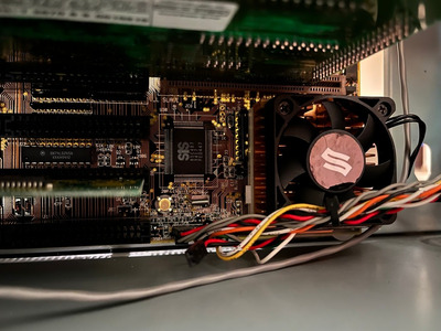

This had me worried, so I then decided to mount a small modern fan on the heatsink with some screws, because screw period correctness, and now the system runs all nice and cool:
159.34 KiB
1397 views
HSF solution for 486DX2
To accomplish this, I had to find a molex-to-3-pin fan compatible adapter since the motherboard has no fan headers at all.

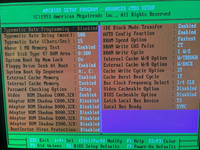

I have considered it - there's not a whole lot to fix though. The BIOS has exactly one page dedicated to advanced settings:
159.54 KiB
1377 views
AMI BIOS Advanced Settings/486
Still, if you have any good pointers I will take them. I seem to recall that what I know to be true for later Pentium based systems such as Video BIOS Shadow and/or caching better being left disabled is exactly the reverse for these early DOS-based systems. Or am I completely off?

You can also get some more Speed by changing Busclk Frequency .
You currently running 33/4 = ~8,25Mhz., changing to CLK/3 will give you 11Mhz ISA Bus Speed.
Some older ISA Cards maybe troublesome, but majority worked for me at 11Mhz Bus Speed.

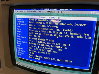

Reply 56 of 71, by TheMobRules
Thanks in advance for taking some time to do this @leonardo.
leonardo wrote on 2023-01-22, 08:33:
A quick search turned up NSSI, - is there a specific process for the dump? I can probably get around to trying this tomorrow.
When dumping the BIOS from a running machine, it's usually recommended to set System/BIOS shadowing (F000 - FFFF) to disabled if possible in the BIOS setup, so that the dump is taken from the ROM itself rather than a copy in memory, which could have some slight variations (though it's usually nothing critical). You can enable shadowing back once you're done.
With NSSI, it's as easy as selecting the Tools --> Save BIOS option from the menu bar. You will be asked for a file name, and it will save it with extension ".BIO" in the current directory. It should be a file with size equal to 65536 bytes (64KB).
You can also double check by dumping using DEBUG, it's also quite simple. Since the BIOS resides at the F000 location in memory, you can copy 64KB from that location (as two chunks of 32KB each) into files and then you can join them:

Sorry about the long wait! I got sick and didn't get around to this until today. I've attached a screenshot of the report summary and the BIOS-file. Hope you find some use for it.
125.73 KiB
945 views
NSSI report
    ms4132.bio.zip
    44.98 KiB
    35 downloads
    BIOS dump

Reply 58 of 71, by TheMobRules
leonardo wrote on 2023-01-30, 18:37:
Thanks a lot leonardo! By quickly examining the file in a hex editor, it seems your BIOS (A75B - Apr-21 1994) is slightly newer than mine (A75A - Mar-31 1994). Very interesting! I wonder if it has fixes for the bugs I noticed in my version, I will test your BIOS in my board in the next few days and will report back.
