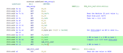

So I started suspecting that it was some kind of software issue. I've downloaded the BIOS ROM file and started to analyse it step by step using Ghidra. Thankfully I had a hardcopy of the "Intel's Sl Architecture: Designing Portable Applications" book that documents the basics of configuring a SL SuperSet system. It was a huge support to search for a moment when the MCBS register (responsible for bank size, see below) was being set. Thankfully I was able to find such a moment in code:

The machine sends either 0x13 or 0x33 to the MCBS register depending on the value read from port 0xC7C, which is the machine ID port for Compaq. Given the possible comfigurations for memory size that can be loaded shown in the appendix for the SL book, I saw that the value 0x13 indicated 2MB in bank 0 and nothing more. I had written on my Contura a small programme in TurboC that probes selected and it actually read 0x13.
222.76 KiB
3245 views
So what I did is that I changed the value in the RAW ROM file at address 0x1C44E from 0x13 to 0x33 (adding 0x20 in hex). I also subtracted 0x20 from the last byte in the ROM file to keep the ROM checksum equal to 0 (changing from 0x84 to 0x64). I flashed the modified ROM. The system booted, but it still did not detect the additional 2M of RAM.

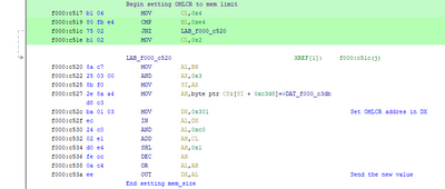

So I kept looking in Ghidra for an instruction pattern where the Machine ID is compared: CMP BL,0xe4.
I have found such a place not far away 😉
35.27 KiB
3245 views
The code above uses the value 0x2 or 0x4 for setting the value of OMLCR, which is used to set the on-board memory limit 😀
I changed the value in the RAW ROM file at address 0x1C51F from 0x02 to 0x04 (adding 0x02 in hex) and in consequence changed the checksum byte to 0x62.

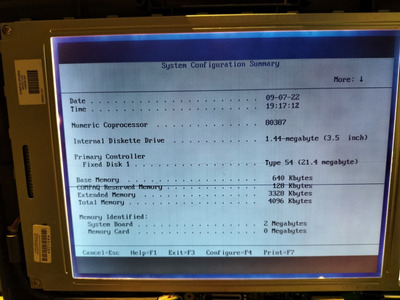

I flashed the new BIOS ROM and booted the new computer. The machine was able to detect full 4M of memory!
The BIOS issued a memory detection error and after running setup it updated the new settings. Although it detects 4096Kb properly, it still shows only 2 Megs on the system board.

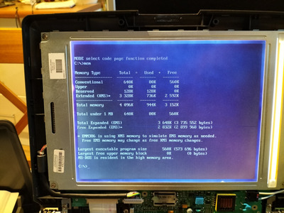

All in all DOS sees the 4M of RAM memory, Checkit tests OK and I am able to run Matlab 4.0!
