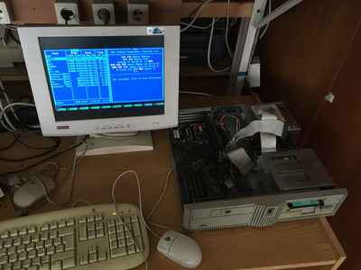

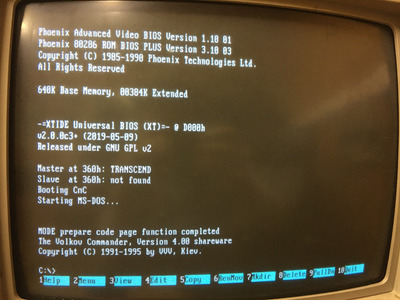

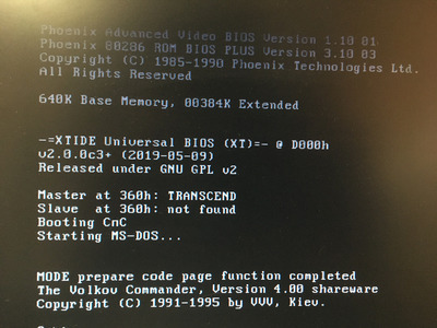

Hello everyone!
Recently salvaged this 1990 PC, which seems to be a kind of IBM/PS2 clone - at least it uses PS/2 mouse and keyboard, 30-pin SIMMs and similar board design. Not an Asian or European clone, though.
Motherboard incorporates COM, LPT, floppy and IDE controllers and even a VGA! Never seen this before. Perhaps, some kind of "ever-cheapest" design for educational market?
Harris 80C286 CPU @ 16 MHz, 1Mb RAM, built-in VGA. Unfortunately, original IDE HDD and even its rack are missing and I cant even imagine how it should be mounted, as the IDE cable is quite short, about 7cm.
Branded "USIT Corporation" and shows USIT logo at boot, while "Athena" seems to be model. I can only read USIT as "U.S. Information Technoligies corp." which still exists, however nowadays it is a software vendor and no traces of hardware history is available (at least, I cant find them).
PC is a decent working condition, starts with a temporary CF-IDE, but obviously needs a good clean, a new drive and a lid.
Any ideas of what is it, its history etc will be highly appreciated!
    1008.77 KiB
    2660 views
    It boots!

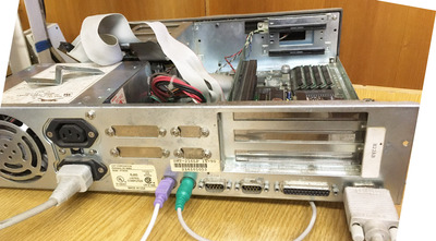

    Backplate

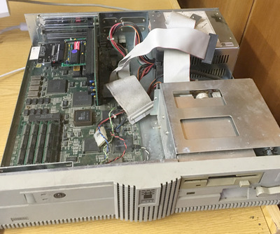

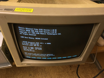

    Internal structure
    1.13 MiB
    2660 views

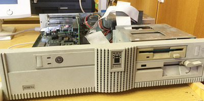

    Face and TM

Reply 1 of 47, by ajacocks
That's a really neat looking 286. And yeah, reminds me a ton of a PS/2 Model 30 286.
I've heard the USIT name, but know nothing about them, unfortunately.
- Alex
Reply 2 of 47, by OSkar000
Really nice 286 in a compact form factor!
It reminds a bit of my 286 that is slightly smaller. Lots of parts integrated to the motherboard, pizzabox desktop case and similar specifications.
Having 3 isa-slots is quite useful if you want sound card, better VGA and a networking card.

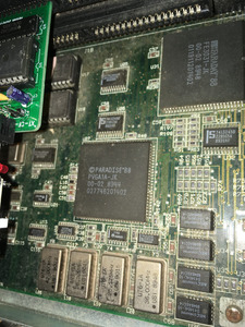

Edit: Just read the leaflet and noticed the specs.
Your 286 can handle up to 4 MB of memory and has a Paradise PVGA1A-JK VGA chip.
That means it can do 800x600 in 16c and 640x400 in 256c.
Higher colour depths might be possible if the video RAM is upgraded from 256KB to 512KB.

Reply 10 of 47, by VileR
perezx wrote on 2022-12-14, 07:58:
https://www.vogons.org/thumbs/50230_95fa8197497d742233f6e7680f542135/IMG_8614.jpg […]
This seems to have a unique looking text mode charset, at least on bootup. Any chance of dumping the VGA and BIOS ROMs, so I could add the font to this or this? 😀

Reply 12 of 47, by perezx

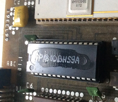

VileR wrote on 2023-01-10, 18:44:
This might be due to 1997 TFT display, which is not capable of stretching image when it is not 1024x768 (native for display). I will start the PC again and set windowed mode, so you can see actual fonts and decide whether you need the dumps.

Soviet chip

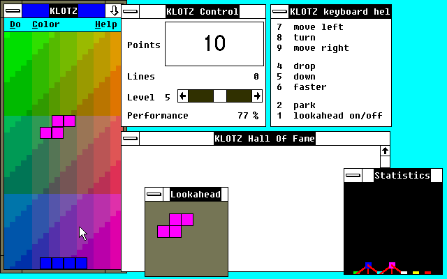

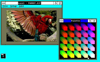

Speaking of the VGA graphics.. I've attached the Windows 2.x drivers for you (ET3k, ET4k, Paradise, V7).
They also work with Windows 3.0 in Real-Mode.
Useful if you work with Windows 1.x/2.x applications.
    26.19 KiB
    2172 views
    Picture viewer on Windows 2.x w/ SVGA; source: toastytech.com
    4.4 KiB
    2172 views
    Klotz game on Windows 2.x w/ SVGA; source: toastytech.com

Reply 15 of 47, by VileR
perezx wrote on 2023-01-12, 15:40:
True, I can see the non-integer stretching. But apart from that, the boot-up screen does have a different font compared to the "normal" one in Volkov Commander (e.g. lower-case "a" looks like "ɑ", squarish-looking "A" and "6" etc).
Since Volkov Commander appears to use a standard VGA font, it's possible that the BIOS is setting its own character bitmaps just for the POST screen... hence why I mentioned the system BIOS as well as the VGA ROM. 😀

Reply 17 of 47, by perezx
Jo22 wrote on 2023-01-12, 17:08:
I'm not saying that it's right / that I'm right, it could be well the case that it is wrong /that I'm wrong.
Since I'm from Europe and never been there at the time, all I can do is to draw conclusions from what I hear/read.
Well, I am not arguing or trying to say you are wrong 😀
Just telling some stories from the USSR past, which, obviously, may be faded due to 30+ years passed...
I tried my best to get the font clear on than Dec-Digital display (oh well, it deserves its own topic!), but finally had to bring up period-correct CRT 😀
I used to work on 5k 27" display for years... cant remember when I saw CRT last time. Barely recalling all these combinations of resolutions and color depths.
Seems that you, guys, advice me installing Win3.0 ? Good idea...

    video chip

Reply 18 of 47, by VileR
perezx wrote on 2023-01-14, 18:02:
Looking good! (My only working CRTs at the moment are CGA - I'll have to find one for VGA if I'm ever going to finish that half-done 486 DX/2 build...)
Interestingly the unique font shows up only in "IMG_8755":
The others have a standard font. They also show "MODE prepare code page function completed", so I guess autoexec is setting up a Cyrillic code page - this overrides the boot-up font and uses the .CPI one from DOS.
I've got a few VBIOS images from cards using the PVGA1A-JK chipset, and none of them have this unique-looking text mode font... so it's either this specific "Phoenix Advanced Video BIOS", or some modification USIT made to the system BIOS (in addition to showing off their logo). 😀
Reply 19 of 47, by perezx
Yes, looks like it is a "proprietary" USIT font. Should I make images of BIOS ROMs?
