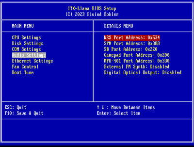

Update:
Happy to report that the digital audio output now seems to work perfectly, thanks to a ton of help and patience from the guru of CS4237, 640K!enough! 🏆
While I'm waiting for parts and new prototypes, I'll do a thorough revamp of the BIOS settings menu, here's a preview:

Reply 161 of 481, by 640K!enough
The better this thing starts to look, the more ideas I get for making it even more elegant. An implementation idea that I like is using register X4 to detect the presence of the external FM module (activate external FM, set timer and busy-wait on the status word until expiry to confirm presence), and offering the option only if it responds. Otherwise, disable the option as "not present".
Reply 162 of 481, by Eivind
640K!enough wrote on 2023-08-10, 20:32:
Ooh, I like that! 👍

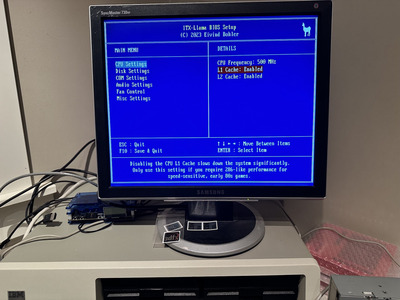

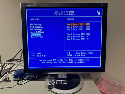

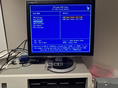

Update:
Still waiting for those illusive AGP ports to reach JLC for assembly... Meanwhile I've been completely rewriting most of my BIOS code (that goes on top of SeaBIOS, of course), complete with a menu system that'll make it soo much easier to modify later. PWM/Tach fan control are in place, working great. As are all other settings, afaik.
Haven't gotten to the external synth detection routine yet, but I think that's next now that the "boring" stuff is mostly done.

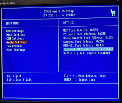

Reply 172 of 481, by Eivind
640K!enough: Here's your auto-detection idea implemented, working fine! 👍

Reply 176 of 481, by 640K!enough
Eivind wrote on 2023-08-17, 16:10:
Implementation was almost exactly what I described, I hope; no unpleasant surprises?
Reply 177 of 481, by Eivind
640K!enough wrote on 2023-08-24, 03:40:
Correct - I just enabled the external FM and ran the good old routine of setting up a timer on the OPL and reading back the status register. No unpleasant surprises! 😁

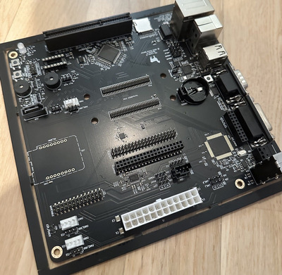

Update:
Just got the boards in, plopped on a Geforce4 Ti4200 AGP card, and got video! 🎉
Will do more tests and programming later today, but that was definitely a sigh-of-relief moment! 😀
