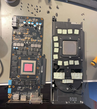

Reply 1 of 35, by pentiumspeed
What is this? Pink thermal paste what it is?
You need at least 8w/mk or higher thermal paste on that Titan Black since this is a high watt GPU. If you have high end GPU, you want to invest well using high end thermal paste!
Cheers,
Great Northern aka Canada.
Reply 2 of 35, by Jackhead
you are kidding me? Thats grizzly Kryonaut extreme..

Reply 11 of 35, by pentiumspeed
Wow in pink! For Grizzly that's unusual. What I had Hydronaut and Kryonaut were grey some are light grey.
Next time, redoing the GPU, buy some thermal putty instead of thermal pads. Knead few times and warm up the heatsink and GPU card makes the putty sticky. This keeps in thermal contact with flexing even there is some gap. Microsoft started using these on Xbox Series S and Series X with success on the VRM MOSFETs and VRAM chips.
Reason they were not warm and not kneaded because microsoft applied cold, made the putty to crack when crushed and not stick well. Warm and kneaded makes putty much sticky, improves this much better and no cracks because I reused them on reassembly.
Right now, people are not aware of thermal pad alternatives such as thermal putty so it is bit harder to find and expensive at this moment. I hope demand increases for this as I really like this so much.
Cheers,
Reply 12 of 35, by Jackhead
Yes there normal kryonaut and the exterme. Thanks for the tip with thermal putty. Will have a look on it.
About the voodoo, i talk about the rebuild from Anthony. I not that creazy buy a original one. And even than i would not build it in a system for daily use.

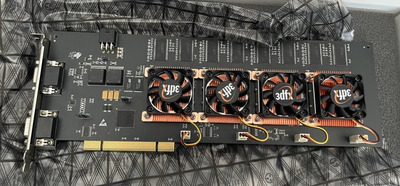

Reply 16 of 35, by Jackhead
The time is come! Got the 6000 today will test later..
150.49 KiB
1767 views
161.82 KiB
1767 views
Dos 6.22: Asus VL/I-486SV2GX4 Rev 2.0 1Mb L2 - AMD A5x86 X5 ADZ 133MHz @160MHz - 64MB RAM - CT2230 - GUS ACE - MPU-401 AT - ET4000W32P
Win98SE: Asus P5K-WS - E8600 @ 4,5GHz - Strange God Voodoo 5 6000 PCI @ 66MHz PCI-X - 2GB DDR2 1066 - Audigy 2 ZS

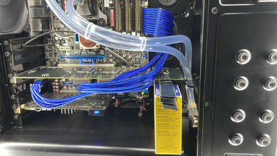

Reply 17 of 35, by buckeye
Strange God indeed! Can't wait to see some benchmarks!
Intel SE440BX P3 450 256MB 80GB SSD Radeon 7200 64mb SB 32pnp 350W 98SE
Reply 18 of 35, by Jackhead
Ok i can confirm the v6000 works on my mainboard on PCI-X 66MHz.
I had to deactivate some PCI-E settings in my Bios. Before that the board get any time "out of range". Had to reset the bios any time before i found the correct settings.
But ok now it boots fine into XP. I will do next a clean install of XP with the voodoo. Than the i7 can fire the voodoo.
The Floppy box GPU Holder is only temp Solution 😀.
800.15 KiB
1715 views
