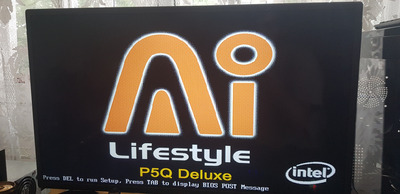

First post, by PcBytes
As the title says, it's a 775 build made out of nearly stuff that was ready for the scrappers if no one bought them.
MB: ASUS P5Q Deluxe
PSU: LC-Power LC6550H v2.2 550W
Case: Techsolo TC10-SR (green)
CPU: Core 2 Quad Q9400
HDD: Western Digital 640GB WD6400AAKS
GPU: Radeon R7 265/HD7850 2GB GDDR5
ODD: Pioneer DVD-106SZ PATA + Optiarc AD-7200S SATA
OS: Windows 10 Enterprise IoT, planning on multi-booting 7 and XP in the future

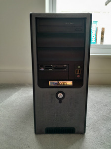

Reply 8 of 18, by chinny22
Your scrap build is better then mine.
CPU: Intel Dual Core E5200 2.50 Ghz
RAM: 4GB Corsair Value Select DDR2 667
GPU: Radeon HD3450 256MB
HDD: 256GB SATA (WD2500-JS)
DVD+RW
Case: In Win C583
OS: WinXP
1.41 MiB
1021 views
Graphics card is definitely holding it back but played a good number of my games ok
It's curranty on ebay for £1 collection only.... and no bids.
I've found a box I can ship in in now so hoping it goes next round, otherwise it IS off to scrap (Originally I tried selling the parts with a £1 starting price but still no interest)
