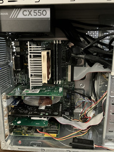

Reply 21 of 44, by pete8475
So this is the current setup of my DOS/98 machine.
I've gone ahead and put the Audigy with optical out header in here too and removed the AWE64.

Reply 22 of 44, by pete8475
I’ve now switched out the Radeon 9200 for a GeForce FX5600XT. I could not get Descent 3 to look right on the 9200.
I76 Gold D3D version runs better on the GeForce too and it’s nice having a cpu slow enough for things like the flamethrower to work properly.

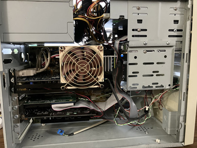

Reply 23 of 44, by pete8475
At first I could not get this motherboard to work with the 600MHZ P3 but after updating the BIOS and finding a newer version of the manual on the Tyan FTP server I was able to get it working flawlessly.
The newer BIOS is hosted right here on Vogons btw! I'm using the Bx46200b.rom included in the archive.
http://vogonsdrivers.com/getfile.php?fileid=1384
USB 2.0 cards also work in this board unlike the Acorp AT slot 1 board so that's very nice.
Final specs:
Tyan Tsunami S1846
Intel Pentium 3 600
512MB PC100 CL2 (1x256, 2x128)
Kingston 128GB SD
LG DVD-RW
beige ATX case
Corsair CX550
Geforce FX5700LE
Sound Blaster Audigy
Promise Ultra 133TX2
Startech USB 2.0 card
3COM 3c515-TX (1o0 Megabit - 🤣)
The only thing I think needs some work is the fan mount for the cooler, right now it's zip tied on very haphazardly.
I re-used the case and power supply from my Tualatin build because I hardly use that machine, the games it was meant for all run fine on my XP Xeon machine. So this slower machine fits the bill for a 98/DOS machine a lot better.
    423.26 KiB
    1128 views

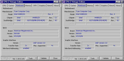

Reply 24 of 44, by pete8475
Something interesting about the BIOS is that the version number only slightly changed but the year number jumped ahead EXACTLY four years. Kind of odd if you ask me.
    78.63 KiB
    1118 views
Reply 25 of 44, by dormcat
pete8475 wrote on 2023-09-04, 02:09:
440BX "Seattle" was released in April 1998 so the date on the left was incorrect; the mainstream Intel chipset back in July 1995 was 430FX "Triton."
Reply 26 of 44, by pete8475
dormcat wrote on 2023-09-04, 03:24:
Yeah that date did seem weird to me, funny that it’s before the release of the chipset! I wonder if it’s an issue with cpu-z misreading it or if it’s just plain wrong to begin with.

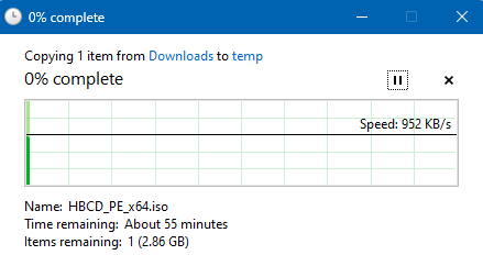

Reply 29 of 44, by pete8475
Disruptor wrote on 2023-09-04, 19:06:
What data rates do you get with your 10/100 ISA network card?
I'll test sending some data to a share on it from my main PC right now and get back to you with numbers shortly.
It is NOT fast btw. I mostly use the network connection to connect to that PC with VNC and do things like game installs while watching stuff on main PC.
Speed is under 1 megabyte/sec.

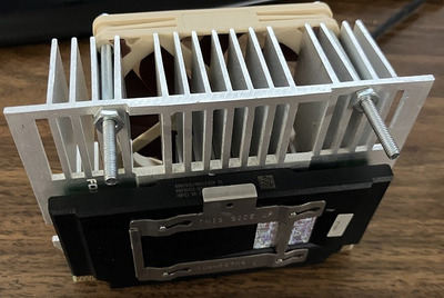

Reply 35 of 44, by pete8475
Fan mounting system has been upgraded to machine screws and nuts, fan is nice and secure now.
I might get some thermal pads to have the cache chips touch the heatsink as well. I doubt it'll make any real difference but the chips are so close to the heatsink...

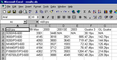

Reply 36 of 44, by pete8475
I can never just leave well enough alone with these things so I've been playing around with various AGP cards I have in here.
I tried copying and pasting this info from excel and it doesn't read very well so instead I've inserted a pic.
13.03 KiB
797 views
Long term I will likely go with either the FX5600XT or FX5700LE. The 5600 is silent and doesn't get silly hot, the 5700 is very quiet. The MX440 is the crappy 64bit version and while the MX400 is probably the most "period correct" it gets too hot for my liking and has some PCB discoloration from years of that heat. The Radeon cards refuse to play nice with Descent 3. I also have a Geforce 3 TI500 somewhere but can't find it at the moment and my TI4200 does not fit with it's giant Zalman heatsink.

Reply 39 of 44, by pentiumspeed
pete8475 wrote on 2023-09-09, 18:52:
I can never just leave well enough alone with these things so I've been playing around with various AGP cards I have in here. […]
Thank you for the benchies. That is what I expect to see especially 5700LE being has working vertex pipelines, more efficient chip and this shows, while 5600 has same pipelines yet clocked bit higher than FX5200 (remember 128bit vram) to keep the comparisons same.
Yet in general Geforce FX is screwed up. FX 5600 better but lacking while 5800 and 5900 so expensive yet the 5700 not compatible with older games due to requiring newer drivers.
I stress on newer driver as a reason I asked about, how you were doing with 5700LE on games. I wonder what kind of games that is not compatible with the FX 5700?
