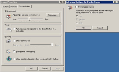

I've been experimenting with Windows ME on this system, and I think I found a use case where it might have a slight advantage over Win98SE - the ability to turn off mouse acceleration.

Under WinME, this can be done from Control Panel > Mouse > Pointer Options > Accelerate. I haven't found a similar setting under Win98SE, at least not without using third-party programs. This is definitively an edge case, and I don't think a lot of people need this functionality. However, if you're using a modern USB gaming mouse on your Win9x retro rig, this is very helpful. I currently have my Logitech G403 HERO hooked up to this system and it's working flawlessly with acceleration turned off under WinME.
BTW, setting up WinME on this system relies on the steps for installing Win98SE, save for a few minor differences. First, I couldn't run WININIT on WinME (it would freeze) so I needed to manually edit SYSTEM.INI and reduce the maximum available RAM there (since I'm using more than 1 GB) and apply R. Loew's PATCHMEM later on. Next, NUSB 3.3 cannot be installed on WinME, but it is needed for USB 2.0 functionality. My solution was to extract the contents of NUSB33.EXE to a folder and manually update the driver for "PCI Universal Serial Bus" from Device Manager by pointing it to that folder. Seems to be working fine.
