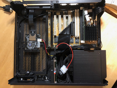

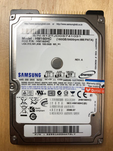

The 2.5" hard drives arrived from China and turns out I'd ordered 160GB drives:
960.57 KiB
646 views
What a perfectly stupid size for retro purposes! Oh well. 😭

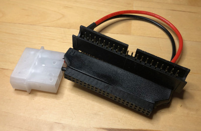

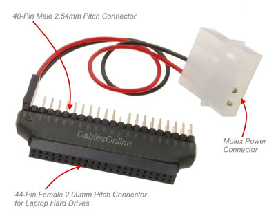

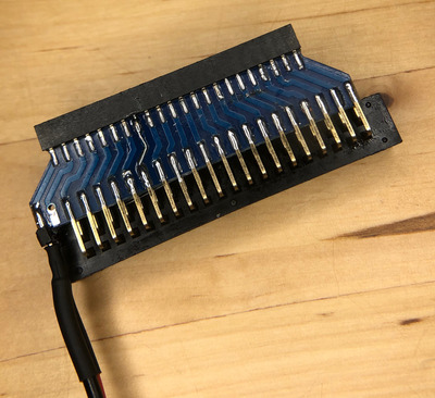

I had a 44-pin to 40-pin adapter like one of these guys:
55.86 KiB
646 views
But there just wasn't enough clearance for the drive in Carmen's case, even in the the spot meant for SSDs. So, since learning to solder is a current project of mine, I decided to attempt swapping out the standard 40-pin header on the adapter with a right-angle one. Removing the existing header from the adapter proved much more challenging than I was expecting, and resulted in some mild mangling of the adapter. I soldiered on, and even did my first attempt at repairing a trace.
743.66 KiB
646 views
All in all, I learned a lot. Put the lil boot back on and it even looks half decent:
808.11 KiB
646 views
'Scuse me for patting myself on the back for accomplishing basic shit, but I'm starting from zero and it's fun. 😘
Anyway, it works!!!!
1.63 MiB
646 views

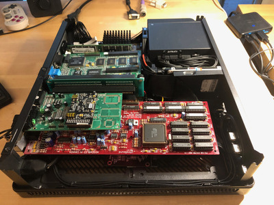

Since it's my thread and no one can stop me, here are some more pics. 😈

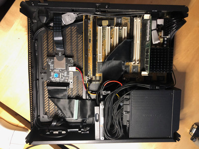

Absolutely keeping the SD card reader as a D: drive (and keeping USB!):
1.74 MiB
640 views
With the cards back in:
1.76 MiB
640 views

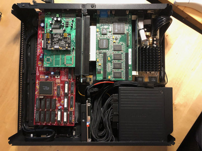

Things looks a little wobbly between the ISA riser and the HD but uhh, it's just the perspective. 🫣
From the side (oh yeah, I bumped the RAM up to 64MB):
1.67 MiB
640 views
And there we go:
1.5 MiB
640 views
Back to being a structurally unsound monitor stand, now with something inside! Some pretty decent somethings actually. Getting a real HD in there and some kind of front-facing removable storage was big. The last thing really holding this build back is the video card which just isn't suited to handling all those fun VESA modes. I'm thinking I'll just suck it up and pay eBay prices for a 4MB Diamond Steath PCI VGA card of some sort.
1.22 MiB
640 views

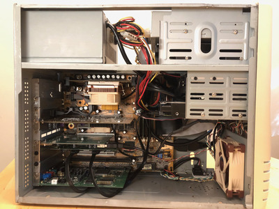

Ok, so here is Toby, the result of the glow-up I gave that beat-up beige mini-tower. IMG_5972.jpeg […]
I replaced the broken, faceplate-missing floppy drive with a GoTek. I think they're going for a more Amiga grey/beige with these? Doesn't matter, impossible to match beiges anyway. Along the same lines, I was never going to find a replacement for the missing 3.5 bay cover, so I put some USB ports there.
Rear:
And inside:
Surprise, it's a Slot 1 build! Here's what I did:
Case: Generic crusty ole AT case
CPU: Pentium III 1.1GHz SL5QW
Mobo: Gigabyte GA-6BA (Intel 440BX, Slot 1)
Memory: 256 MB (2 * 128MB PC133 DIMMs)
Graphics: ASUS V8200T2 Pure GeForce3 AGP 64MB
Sound: Sound Blaster AWE64 (CT4520)
Storage: Promise FastTrak S150 TX4 (PCI SATA controller)
/w 2 * 2TB Seagate Baracuda SATA drives
Misc: USB 2.0 PCI card (NEC chipset)
Removable Media: MSI DVD-RW IDE
GoTek USB floppy emulator
Front Panel USB 2.0
So I kinda have a thing for Baby AT and mATX Slot 1 boards. 🤷‍♂️ Not a whole lot to say about this one. The ridiculous storage situation is a result of me seeing what the biggest drives it could take from my stack of retired NAS drives. And then I made a striped array with them. 😈 For the PSU, after blowing out half a pound of dust out of it, the original one seemed to be in decent enough shape, so I reused it.
No sneaky cable management shenanigans with this old case:
'nother inside angle:
I like this one for a solid, unassuming, utility/bench computer. Its jankiness reminds me of my old AT case that served me from 386SX through to P200 back in the day.

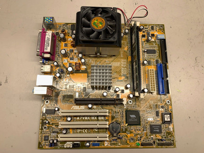

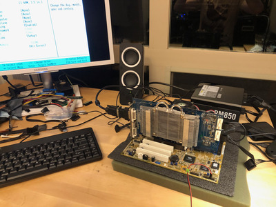

A few weeks ago I happened on an eBay listing for a "ASUS A7V8X-MX SE, Socket A, AMD Motherboard Athlon XP 2600+ Barton 512M RAM" with zero bids, zero reserve, and two days left.
381.33 KiB
514 views
I threw $10 at it and ended up winning it! This is my first real eBay "score" so I'm feeling pretty chuffed about it. 😊 Sure, the shipping was 4x the amount but whatever, it actually showed up as listed, fully working:
1.3 MiB
514 views

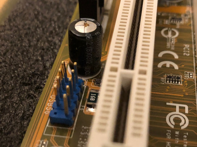

It does have at least one bad cap that needs some attention, but that's not unexpected:
1.23 MiB
514 views
I wasn't particularly planning on building an Althon XP system, but it fits well with what I already have, as my current fastest retro PC is a Slot 1 P3-1100MHz (Toby). I also have the perfect case for it, the one I was originally using for Penny in this old pic:
1.26 MiB
514 views
(Hmm, that looked pretty good... no removable media really killed any Socket 7 build I tried in this case though)

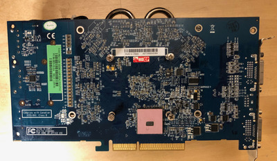

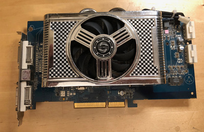

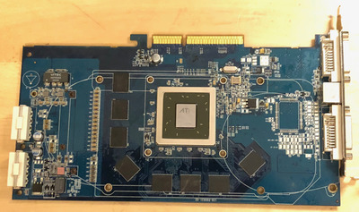

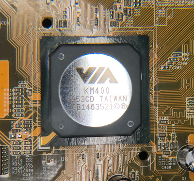

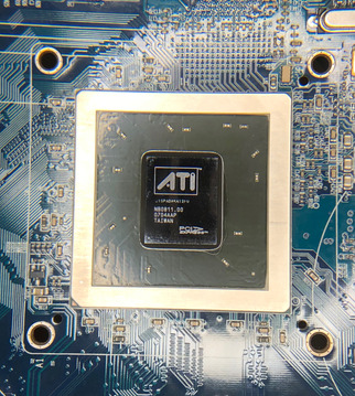

I didn't know what it was when I found it, only that it was huge and had an AGP connector. Not sure I even tried it out before now.
So I must have some sort of mental block, because I just don't remember this era of GPUs. Assuming the hideous HSF is aftermarket. Still, why is the card so weirdly huge yet sparse?
1.19 MiB
505 views
Yeah, It's a bridged PCI-E chip:
1.59 MiB
505 views
So I'm guessing this is just what late-era AGP cards looked like. Just kind of low effort design. It's also oddly wider than modern GPUs, extending past the end of the slot bracket like a card from the 80's.

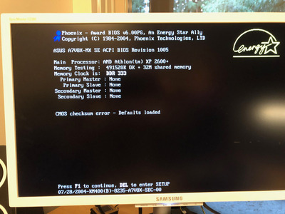

Anyway, it works!
1.49 MiB
505 views
So we're in business. 😈

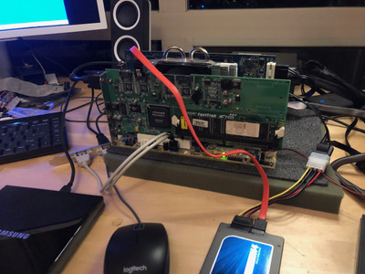

Since I'm using a silly-huge GPU, might as well dig out the similarly silly (periord correct!) Promise SATA controller I have:
1.48 MiB
485 views
Yeah, it has a standard-ass 168-pin DIMM socket with a PC133 256MB DIMM in it. 😅 Anyway, I'm booting and installing Windows XP off a USB 2.0 CDROM drive just because this mobo can and that's neat.

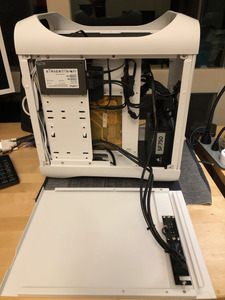

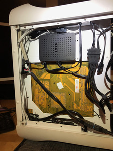

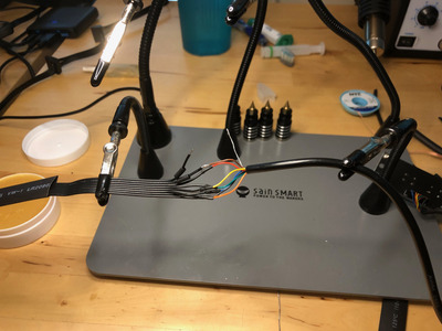

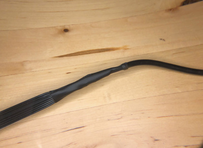

Now for the case... after digging it out, I remembered that the front panel ribbon cable was a mess. To fix it, I decided to frankenstein a HD Audio cable from another case to the mobo-header end of the ribbon cable.
1.02 MiB
485 views
As a total newb I had no idea what I was doing, did not look up any Youtubes for reference, and just made it up as I went. Had about 2" of too-big heat shrink that I made go the distance.
Heck yeah, heat shrink hides all crimes:
664.49 KiB
485 views
And it works!
1.26 MiB
485 views

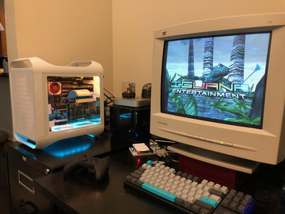

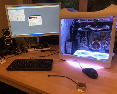

Plop it all into the case and heck yeah, I think we're cookin with gas:
1.25 MiB
485 views
I was hoping something like OpenRGB would work in XP, but no go, so I'll stick with offloading RBG control to my Win 11 machine.
Early days playing with this build - yikes, it's more difficult than I expected to get games from the early 2000's working. And the ways they don't work are often not helpful - sometimes just exiting with no message. Memory management in DOS wasn't fun, but at least games told you what they needed!

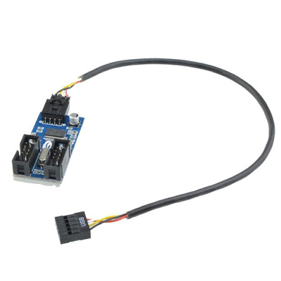

Bit of a messy pic, on the left edge of the case I'm using one of my favourite lil guys, a USB 2.0 splitter:
949.41 KiB
425 views
One of these guys:
41.53 KiB
425 views
Honestly, they're one of my "secret weapons" - I've found them extremely versatile for retro stuff, especially connecting modern case's USB ports to PCI USB 2.o cards (that just have an internal USB jack, not a header). I think I use one in most of my builds. Here, since the mobo only has one USB header, I was using it to connect the case's ports and also the fan controller. Since no XP support for the latter, I just added a slot bracket breakout with a couple more ports.

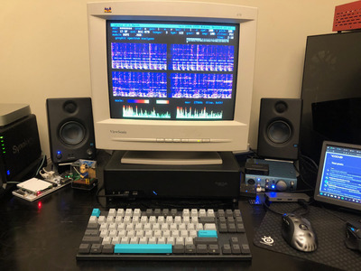

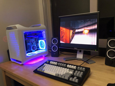

Tidied up my desk, sorted the RGB and got it pushing some pixels:
1.39 MiB
425 views
PWM-dimmed LEDs always show up max bright in pics, but IRL it's a fraction as bright.
Liking this build so far - more appropriate platform for this case than a Socket 7 where I was always frustrated by no removable media. Honestly though... I have no real nostalgia for this era of computing. At least, not for any of the games. (Well, full disclosure I guess - in my gaming cred cv, there's a bit of a gap here that can be explained by "World of Warcraft was released November 23 2004")
Anyway, if nothing else, good use of a case I wasn't otherwise using, and it fills a gap in my ~retro collection~
Reply 28 of 34, by Bruno128
ubiq wrote on 2023-11-03, 21:47:
I have exactly same HM160HC drive with 3.5 interposer and used Seagate SeaTools (bootable dos version) to limit its reported capacity to 120gb. Worked like a charm with a fussy old bios.

Isn't it just a 4-port hub on a board? Very cool, nonetheless 😀

I also like those internal USB hubs. They are a much better solutions for installing older boards in newer cases because extra PCI USB controllers not only can't emulate keyboard but do add driver overhead.
Also, for motherboards that have not a single internal USB header you can connect those hubs with a USB Type-A cable to the rear i/o section. As done here.

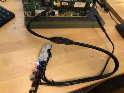

Yup, it's just a little internal USB hub! So, "splitter" is arguably not the right word, but it's what Amazon lists them as. 🤷‍♂️
I'm using one as you describe in my "Toby" build (tucked into the right-hand corner):
1.31 MiB
318 views
It's plugged into the internal jack of the USB 2.0 card and connects the front panel USB 2.0 ports I added. 😊

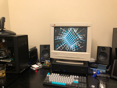

Hooked Carmen up to my home theatre through a recently acquired OSSC:
529.45 KiB
280 views
Just a temporary thing, but I wanted to enjoy the novelty of hooking a real GUS-equipped system up in the living room. Fun!
913.83 KiB
280 views
The OSSC is not really the right tool for the job, but it works well enough. Unfortunately, DOS demos are constantly switching resolutions, which hitches up the OSSC each time (understandable) and also interrupts the audio, since the OSSC is feeding that into the HDMI signal it's producing.
Anyway this is kind like coming home, as this is case used to house my Gaming/HTPC. I could never resolve the significant heat issues I had though, since no matter what I did to the case, it didn't change the fact that it was suck in a tiny cubby with no airflow. I finally gave up and switched to a much bigger case with fans on the front to blow out.
